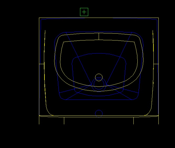

I have two different blocks overlapped on each other which have similar or same geometries. I want to verify the visual difference on both the blocks. I want to verify if the vendor block contains the same geometry as mine.
Here is what I'm thinking and Need lisp for:
I want to select the first block, deselect it, select the other one, deselect it and then this process should be looped till I can visaully find difference between blocks by select/highlight method without grips. If possible to add timer between selection & deselection process would make things easier and allow zoom and pan while still looping.
Can anybody help me please?
There is an app at the AutoDesk Exchange called Fast File Diff that will compare differences between two files. "Fast File Diff quickly creates a merged file with 3 colors: Magenta for differences in File 1 only, Cyan for differences in File 2 only, and Gray for the same in both. The differences between the two files are easily recognizable..."

Why not xref-in the second block and put in on color blue or color 251 and your block in the current drawing to color yellow or magenta. So you can visually see the difference rather than flipping between 2 drawings.

Lee,
Wow, this does exactly what I described. I see you have the delay timer as well. Absolutely fantastic.
The only thing I noticed is while running this LISP, when I press Esc instead of `Press any key to exit...' I lost one of the block. But this works great as is.

If the entities are overlapping and if the color is also same (and the block is huge in terms of length), its not possible to be very sure to make out the difference between blocks.
