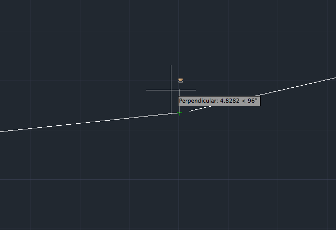

So the way to achive what I was looking for is doing is the way rkent is describing under "1." But with only OSNAP set to "on", no POLAR , no OTRACKING. When moving in the 90° direction I have a white x appearing (which I could not capivate with the screen shot here underneath) and "perpendicular" written.
This is f****** practical!!!
