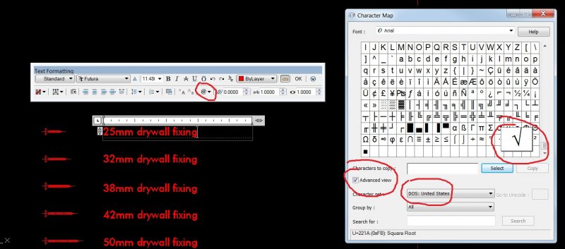

RobinF Posted August 5, 2013 Share Posted August 5, 2013 Hey! As the title says, how do I write the "root" symbol? Thanks for any help! Quote Link to comment Share on other sites More sharing options...
Fire_col Posted August 5, 2013 Share Posted August 5, 2013 In your text formatting bar go to symbol "@", From the list select other..", in the character map dialogue select "Advanced View" choose the character set "DOS: United States" Scroll down and the root symbol is at the bottom. As shown. Quote Link to comment Share on other sites More sharing options...
