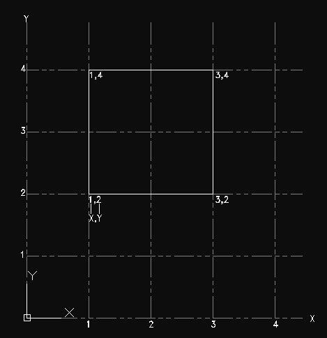

Look at the attached and see if it explains things for you.

if you examine the differences in the x and y coordinates for successive points, you will see the logic that will create a square.
Watch out for Absolute coordinates # and Relative coordinates.
AutoCAD used to default to Absolute and now defaults to Relative @.

Hi Rkent.
Thanks so much for your effort.
The penny has dropped.
What I realized was that the grid actually appears in 1 half increments.
I am no longer confused.
Thanks
