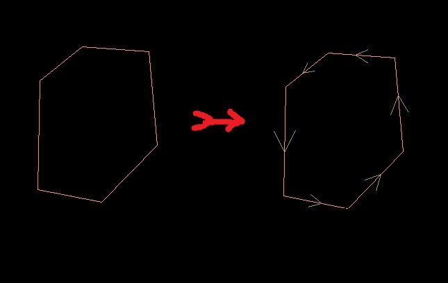

Hi to everyone
Does anyone have or know of a LISP application that will automatically place an arrow on a polyline to show what direction it has been drawn?
1) select a polyline
2)Then place an arrow on the pline, which pointing the direction
What exactly are you trying to accomplish? What type of drawing is being created?
Look Into MEASURE and DIVIDE Commands. They have a block option that can be aligned with the PLINE. -David
Or possibly create a linetype with arrows, and temporarily change the polyline's linetype.
I need to know if the polyline is clockwise or counter clockwise .I dont want to measure or divide something.I need this because help me in dimensioning
yes i do this but i need something faster . if it possible
See Below
You didn't say that. There are lots of CW CCW routines around. -David
:D Thank you David , I dont now if i can find something better , but for now troggarf lisp is just fine.
Thanks a lot :beer:
:roll:

Thanks marko_ribar but i need only to know the direction and not to change the direction. troggarf lisp is exactly what i need.

The only thing i want to change is if someone can the (direction arrow) on top of the polyline .
Thanks :)

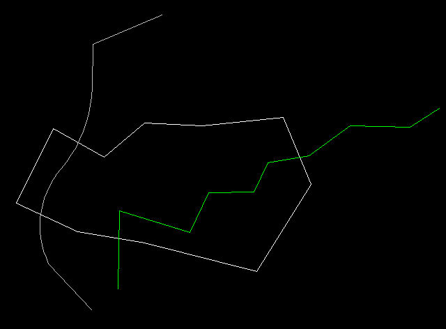

	    (t 1.0)
theta (* 4.0 (atan (abs bulge)))
 (if (> theta pi)
   (setq theta	(- (* 2.0 pi) theta)
  dir	(* -1.0 dir)
 (setq	theta (/ theta 2.0)
radio (abs (/ (distance fromvertex p2) (* 2.0 (abs (sin theta)))))
beta  (+ (angle fromvertex p2) (* (- (/ pi 2.0) theta) dir))
pc    (polar fromvertex beta radio)
 (getarcsegment pc radio p2 fromvertex)
(defun getlwpolydata
      (vla_poly / name endparam param closed fromvertex p2 midp bulge vlist)
 (setq closed (vla-get-closed vla_poly))
 (setq endparam (vlax-curve-getendparam vla_poly))
 (setq param endparam)
 (setq i 0)
 (while (> param 0)
   (setq param (1- param))
   (setq fromvertex (vlax-curve-getpointatparam vla_poly i))
   (if	(vlax-property-available-p vla_poly 'bulge)
     (setq bulge (vla-getbulge vla_poly (fix i)))
   (setq nextvertex (vlax-curve-getpointatparam vla_poly (+ i 1)))
   (setq dis (distance fromvertex nextvertex))
   (setq midpt (vlax-curve-getpointatparam vla_poly (+ i 0.5)))
   (if	(and bulge (not (zerop bulge)))
     (progn (setq bulge (getbulgedata bulge fromvertex nextvertex))
     (setq etype "ARC")
     (progn bulge (setq etype "LINE"))
;;;;;;    (if	(not :rcmPrefixArcText)
;;;;;;      (setq :rcmPrefixArcText "L="))
   (setq vlist	(cons (list ;; numero vertice
		    (+ i 1)
		    ;; tipo de objeto
		    etype
		    ;; punto medio
		    midpt
		    ;; inicia vertice
		    fromvertex
		    ;; termina vertice
		    nextvertex
		    ;; longitud de curva o recta
;;;;;;	       (if (= eType "ARC")
;;;;;;		 (strcat
;;;;;;		   :rcmPrefixArcText
;;;;;;		   (rtos bulge (rcmd-getUnits-mode) :rcmPrec))
;;;;;;		 ;; es una recta
;;;;;;		 (rtos dis (rcmd-getUnits-mode) :rcmPrec))
	      vlist
   (setq i (1+ i))
 (reverse vlist)
(defun dib_flechdir (lst_dat / unidad angf dirf pfm pf1 pf2 pf3 pf4 pftemp)
 ;; establecer longitud de flecha de acuerdo a la altura de pantalla
 ;; para dibujar las flechas iguales a cualquier nivel de zoom
 (setq unidad (/ (getvar "VIEWSIZE") 15))
 (foreach dat lst_dat
   (setq angf (cadr dat)
  dirf (caddr dat)
  pfm  (polar (car dat) (+ angf (/ pi 2)) (* unidad 0.3))
  pf1  (polar pfm (- angf pi) (/ unidad 2.0))
  pf2  (polar pfm angf (/ unidad 2.0))
   (if	(= dirf 1)
     (setq pf3	(polar pf2 (- angf (/ (* pi 5.0) 6.0)) (/ unidad 4.0))
    pf4	(polar pf2 (+ angf (/ (* pi 5.0) 6.0)) (/ unidad 4.0))
     (setq pftemp pf1
    pf1	   pf2
    pf2	   pftemp
    pf3	   (polar pf2 (+ angf (/ pi 6.0)) (/ unidad 4.0))
    pf4	   (polar pf2 (- angf (/ pi 6.0)) (/ unidad 4.0))
   (if	flag_dir
     (progn ;; dibujar flecha color verde
     ;; cuando se le cambie de direccion
     (grdraw pf1 pf2 3)
     (grdraw pf2 pf3 3)
     (grdraw pf2 pf4 3)
     (grdraw pf1 pf2 4)
     (grdraw pf2 pf3 4)
     (grdraw pf2 pf4 4)
 (setq flag_dir nil)
;;; Command for test...
(defun c:PLD (/ pol obj pol_data)
 (setq	pol	 (car (entsel "\nSelect polyline: "))
obj	 (vlax-ename->vla-object pol)
pol_data (getlwpolydata obj)
 (dib_flechdir
   (setq lst_dat
   (vl-remove
     nil
     (mapcar (function (lambda (i)
			 (if (nth 2 i)
			   (list (nth 2 i) (angle (nth 3 i) (nth 4 i)) 1)
	     pol_data
Thanks :)
