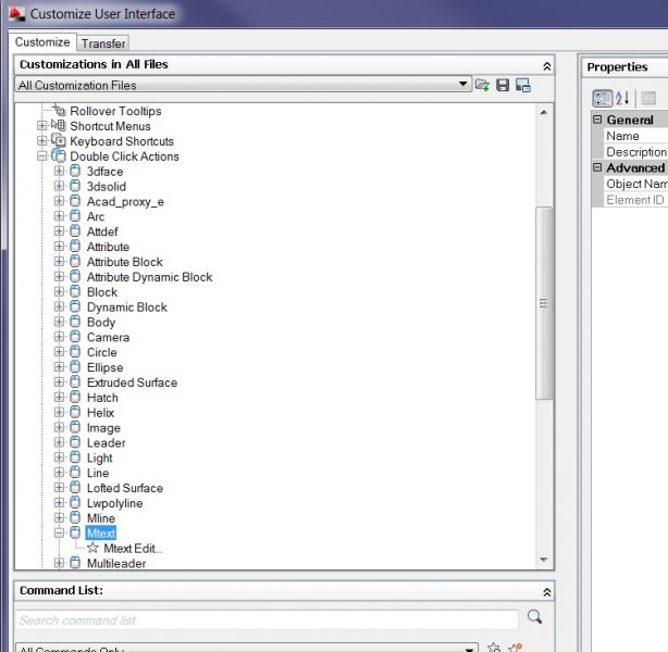

Type CUI and then drag and drop mtext edit into the double click action area. I'm fairly certain that this exists in LT :)
