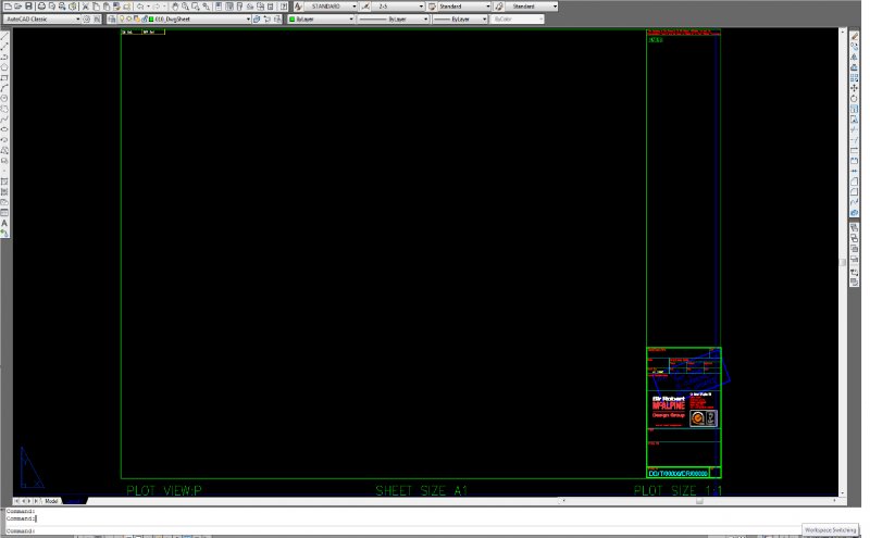

*EDIT* Personally I work with AutoCAD classic layout, as it suits my style of 'Everything must have it's clearly defined place' workspace! :lol: It also means I get a separate tab that appears next to the text I'm working with, though I'm not sure LT supports it as It goes AutoCAD Classic, Drafting and Annotation (Ribbon toolbar), 3D Basic and Modelling. (See bottom right, where tooltip is showing)

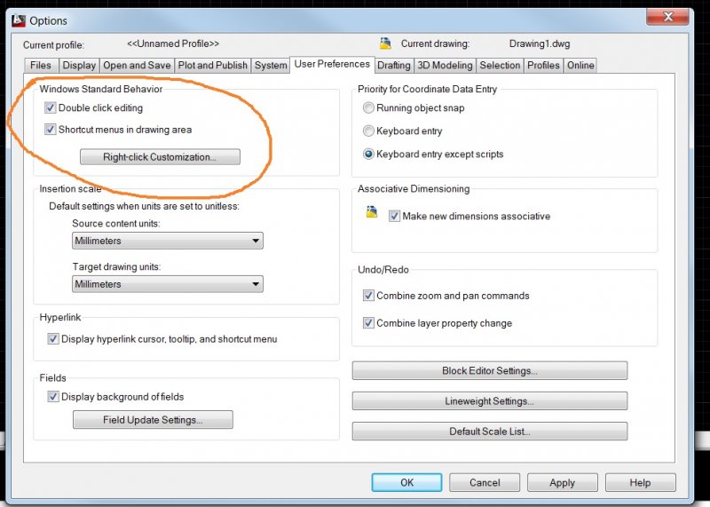

After restart also make sure that you go in to the option (command: op) dialogue and reset your mouse button options.
Edit: See attached...
Good shout Fire_col.
Didn't think there would be an option to enable or disable a function like that. :beer:

Check your options and go to the tab Fire_col is on and ensure the area he's highlighted is on.
[ATTACH=CONFIG]43212[/ATTACH]

Is double click enabled? Did you check your options?
If so, then I'll look into it, but I'm a little stumped. In the mean time, _mtedit will suffice as a workaround but I understand it isn't what you're after.

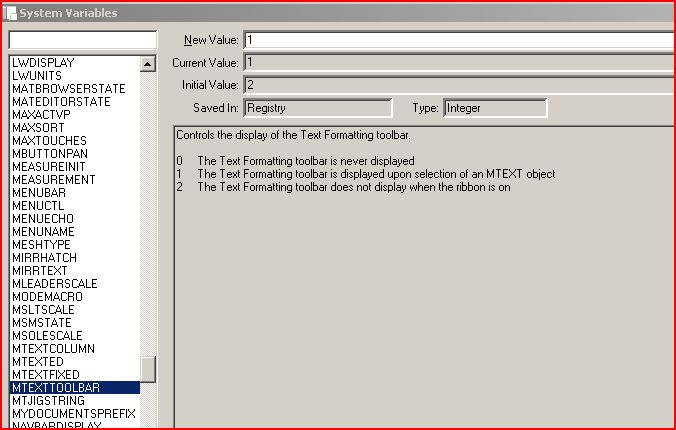

If you have enabled double click editing as Fire-col suggested,
then you probably need to set your MTEXTTOOLBAR variable, as
explained in the image.
Question - What's the command code needed to reach system variables?
Yeah I want to know that too :P.
That option and more can be found by right clicking in the text area once you have the editor open and selecting "Editor Settings".
The toolbar can also be turned off from the ribbon while in the text editor. Go to the highlighted "Text Editor" tab, then to the Options panel and click "More", then editor settings.
SYSVDLG = system variable dialog
This is from Express Tools: ExpressTools|Tools|System Variable Editor --it's almost the same whether via the Menubar or Ribbon.
