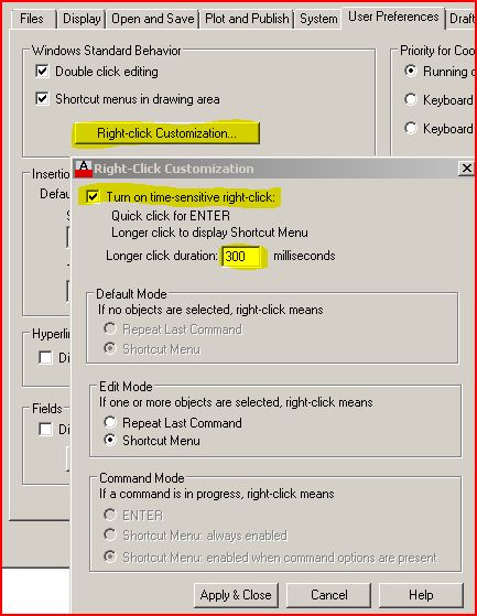

Have you tried adjusting the RIGHT CLICK DURATION?
In your time-sensitive right click dialog?

I've changed the right click duration from the default 250ms to 500, and I'll see if I can get a video uploaded somehow.
