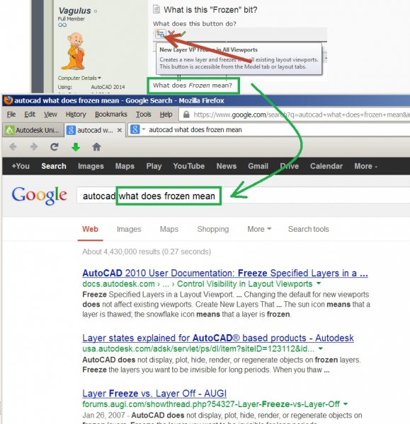

Vagulus Posted July 28, 2013 Posted July 28, 2013 What does this button do? What does Frozen mean? Quote
nestly Posted July 28, 2013 Posted July 28, 2013 Here's my #1 tip for getting answers about anything related to AutoCAD. Open a browser, go to Google, type the word "AutoCAD" then type your question as if you were asking an Autocad expert sitting right next to you. Quote

nestly Posted July 28, 2013 Posted July 28, 2013 I didn't post the Google thing lightly... I posted it because it's what I use most often answer my own questions. I reviewed the Google search results and determined the first result provided a comprehensive overview of "frozen" layers (as well as direct answer in the 3rd section) BTW, files at docs.autodesk.com are actual Help files for Autodesk products. Quote

Vagulus Posted July 29, 2013 Author Posted July 29, 2013 (edited) . I reviewed the Google search results and determined the first result provided a comprehensive overview of "frozen" layers (as well as direct answer in the 3rd section). I am sorry, but I cannot see any answers that are useful to me. One of the things they hammered into me at university is that you cannot provide a comprehensible explanation of jargon using the same jargon. That is what is happening here. I assume that you know what they are talking about. That is a massive advantage over someone who has no idea what they are talking about. Take, for example the use of the terms VP, xref, and VISRETAIN. You've lost me in three quick moves. (I did enter VISRETAIN at the command line and it shows a value of 1.) I note that the first post at that link includes the line, "If my understanding of this feature is correct, it has never worked as advertised." I hope that is not the epitaph for the button. Edited July 29, 2013 by Vagulus My mistake Quote
nestly Posted July 29, 2013 Posted July 29, 2013 "Frozen layers are invisible. They are not regenerated or plotted. In the illustration, the layer showing terrain has been frozen in one viewport." "Thawing the layer restores visibility. The easiest way to freeze or thaw layers in the current viewport is to use the Layer Properties Manager. " Source Quote

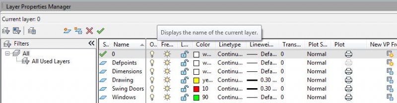

Vagulus Posted July 29, 2013 Author Posted July 29, 2013 The easiest way to freeze or thaw layers in the current viewport is to use the Layer Properties Manager.QUOTE] I hope that drawing is of a house on a hill. It wouldn't have much of a view from a valley! Some house, BTW! Hopefully this is the last question in this thread: Here is my Layer Properties Manager for a drawing with layers. Here is what I see in my Drawing Area. Why can I still see windows and doors etc.? Quote
nestly Posted July 29, 2013 Posted July 29, 2013 Although I can't tell from the drawing area, all indications are that you're currently in Modelspace, in which case, "VP" properties do not apply. VP settings are only used in Layout tabs, where each Layer display can be controlled differently for each viewport (as per the house plan above) To Freeze/Thaw layers in Modelspace, use the "snowflake" between the "lightbulb" and the "Lock" icons. The icons at the far right of your screenshot are a "snowfake" on top of a "Viewport" Quote
Vagulus Posted July 29, 2013 Author Posted July 29, 2013 Great!:D:D That's what I was looking for. IPOF I located similar functionality in the Layer Propertied Manager. I expanded a column and found it to be Freeze and that did the job. Your way is slicker, and quicker, and all that stuff. We made it! Thanks for hanging in on the search. People who are trying to do this solo rely on you folk more than your could imagine. Quote
danellis Posted July 30, 2013 Posted July 30, 2013 The button you initially asked about will create a new layer that is thawed (i.e. visible) in model space but frozen (invisible) in all existing viewports. The freeze button you found is used to freeze (or thaw) an existing layer everywhere. I'm not sure from your posts how likely it is that you understand viewports - I'll leave it like this for now but am happy to explain them if you want me to. dJE Quote
