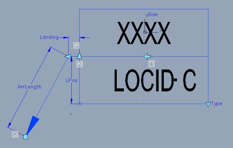

Vedgard,
First of all I am by now means a CAD master. However, my recommendation would be to add a leader to the dynamic block that has attribute lines for what you need. I attached a s screen shot of similar one I used. Then using visual lisp you should be able to pull out the information and update the block information. Some sources to reference
Afralisp.net: If you look under the visual lisp section you should be able to learn how to pull out the information from the polyline.
http://www.theswamp.org/index.php?topic=22663.0 : There is some coding written here for updating attribute that I find very useful. putdynpropvalue, getdynprops, getdynpropvalue Written and tweaked by I think by Jeff Mishler, Steve Doman, Herman Mayfarth and Tony Tanzillo

Forgot to add the picture.
