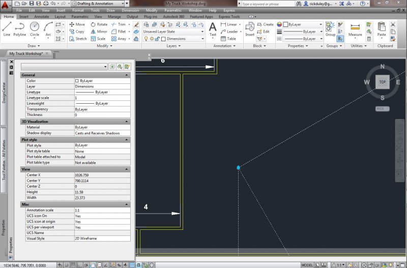

Vagulus Posted July 26, 2013 Posted July 26, 2013 When I enter CTRL+1 at the command line I get this What I want is this Properties Manager with the capability to adjust Scale X, Y, and Z. How do I get this one? Quote
Fire_col Posted July 26, 2013 Posted July 26, 2013 This might be a tupid question but, you do have something selected when you open properties? You'll only be able to manipulate geometry if you have something selected. Quote
feargt Posted July 26, 2013 Posted July 26, 2013 ...... you do have something selected when you open properties? You'll only be able to manipulate geometry if you have something selected. That was my first thought Quote
Vagulus Posted July 26, 2013 Author Posted July 26, 2013 This might be a tupid question but, you do have something selected when you open properties? You'll only be able to manipulate geometry if you have something selected. It's not half as dumb as some of the questions I ask - but I only ask them because I don't know Yes, I have something selected. Quote
feargt Posted July 26, 2013 Posted July 26, 2013 If you look at the top of the two images that you posted, you will see in the second image that a block reference was selected, and that means you see the relative properties that apply to such an object. In the first image, no object is listed as being selected and the image displays as expected when no object is selected. Try it again when nothing is selected and then when you have an object selected. You will also see that different objects have different types of properties. Quote
Fire_col Posted July 26, 2013 Posted July 26, 2013 It was my question I was referring to as possibly stupid, not yours. The reason I ask as the image you posted suggests that nothing is selected. Ok try unselecting your item(s) and closing the proerties pallette. Then open the proerties pallette again, try typing PR instead, then select your item(s) again and see if it picks them up this time. Quote

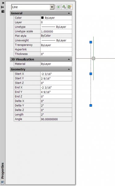

nestly Posted July 26, 2013 Posted July 26, 2013 @ Vagulus Draw a line, select it, and post a screencap of the Line AND properties palette as shown below. If the Properties palette does not show the properties for the selected line, then you have another problem that we can help you fix. Quote

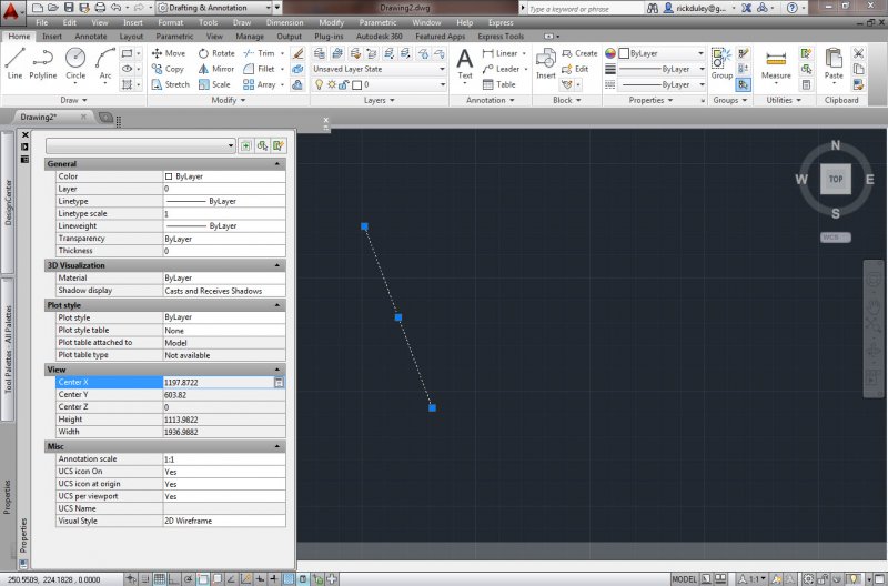

Vagulus Posted July 26, 2013 Author Posted July 26, 2013 If you look at the top of the two images that you posted, you will see in the second image that a block reference was selected, and that means you see the relative properties that apply to such an object.In the first image, no object is listed as being selected and the image displays as expected when no object is selected. Try it again when nothing is selected and then when you have an object selected. You will also see that different objects have different types of properties. It doesn't seem to make any difference. Quote
Vagulus Posted July 26, 2013 Author Posted July 26, 2013 That doesn't make any difference either. As Alice put it - "Curiouser and curiouser!" Quote
nestly Posted July 27, 2013 Posted July 27, 2013 That doesn't make any difference either. OK, you have to resolve this in order for AutoCAD to function properly. In Tools > Options > Selection is Noun/Verb selection checked? (If not, check it and see if the Properties Palette displays the Properties of a Selected object) Have you run a registry cleaner since you installed AutoCAD? Have you uninstalled the Autodesk360 component? (if you don't know, then you haven't) Quote
Vagulus Posted July 28, 2013 Author Posted July 28, 2013 OK, you have to resolve this in order for AutoCAD to function properly. In Tools > Options > Selection is Noun/Verb selection checked? (If not, check it and see if the Properties Palette displays the Properties of a Selected object) Have you run a registry cleaner since you installed AutoCAD? Have you uninstalled the Autodesk360 component? (if you don't know, then you haven't) Noun/Verb is checked. I ran CClean registry cleaner yesterday but it made no difference. Yes, I have uninstalled Autodesk360. Quote
nestly Posted July 28, 2013 Posted July 28, 2013 Registry cleaners are known to cause problems with the Properties Palette. Similarly, uninstalling Autodesk360 has been reported to sometimes cause the same error, so you're going to need to repair/reinstall AutoCAD. Autodesk Knowledge Base article --> Properties palette blank after selecting object Autodesk forums (related to uninstalling 360) --> Properties Palette Quote
Vagulus Posted July 28, 2013 Author Posted July 28, 2013 so you're going to need to repair/reinstall AutoCAD./QUOTE] That fixed it. Thanks again Quote
