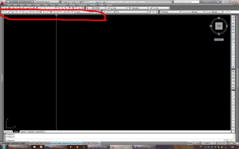

I'm having trouble setting up my toolbars. I position them the way I want, but as soon as I switch back from a different workspace (lets say3D modeling) the position of the toolbars change. Allsow I can't get the scroll bars to disappear for good, they always come back :ouch:
Here is what I do exactly:
1. Change the content and the position of the toolbars (acad classic workspace)
2. Lock down the toolbars
3. Go to options => profiles, create a new profile (add to list), set current
4. Change workspace to 3D modeling
5. Change workspace back to acad classic
The result is: content of the toolbars is the way I want, but the position is changed. The toolbars are locked, so in order to move them to the desired place I have to unlock...
This is rly annoying. Anyone had the same problem, or heard of the solution?
