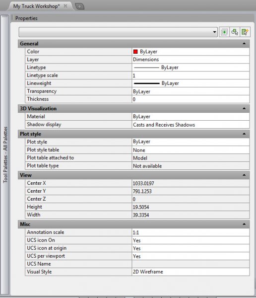

Here are the properties I get for the Door.
The command UNITS at the command line gets me nothing which I see as adjusting the Insertion Scale which is Millimeters.
Which of the properties shown do I have to adjust, and how do I adjust them?
1) It does not appear you have anything selected, so the Properties palette is displaying the current settings for the drawing.
2) Have a look at this to see the difference Insertion Scale has when inserting the same block.
1)

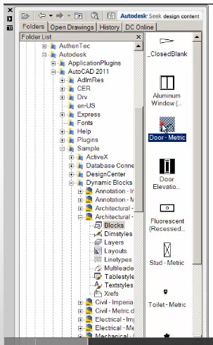

Design Center Palette (DC from the Command line) was used to access the sample blocks included with AutoCAD. The sample blocks/drawings are located at
C:/Program Files/Autodesk/AutoCADxxxx/Sample/DesignCenter
The small dialog box was the drawing UNITS dialog box.

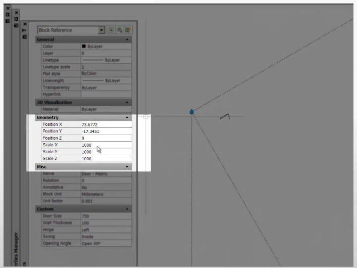

Thanks for the second video - I follow that okay. It seems, however, that the real trick was in the first video.
What is THIS dialog, and how do I get to it? It is resetting X, Y, and Z that fixes the problem.
That is the Properties Palette. You can access it by these methods, among others.
1) CTRL + 1
2) PR at the Command line
3) Select an object and Right-Click, then select "Properties" from the menu
4) Click the downward facing arrow on the bottom right of the Ribbon Properties panel.

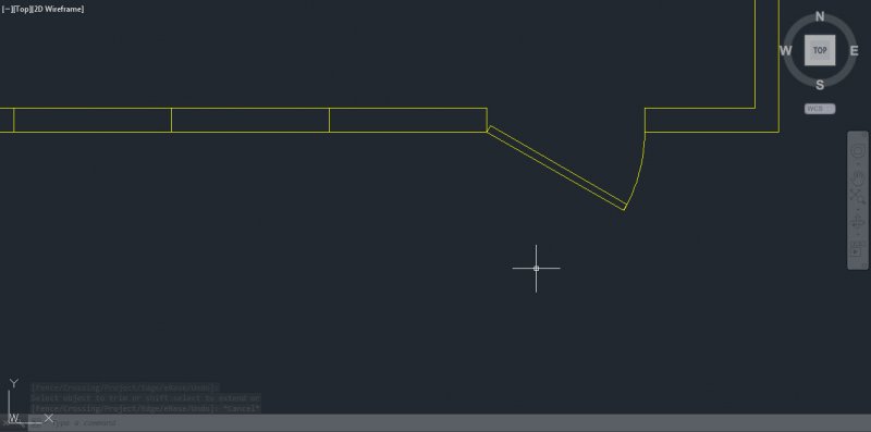

What do I have wrong here?
