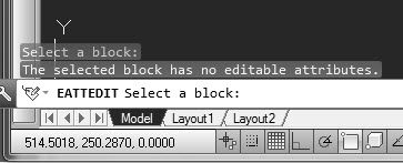

I tried what I think you mean as the block editor and got this
Where do I go from here?

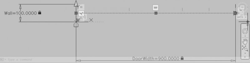

I kept poking around and I wound up somewhere, and I'm not sure where. I THINK this window was giving me the permitted dimensions of a window.
Since I am working in metres, I think this means that I can fit a window up to 900m long in a wall up to 100m think. Therefore, assuming this to be correct, I should be able to get the window 2m wide in a 150mm concrete block wall.
Yes?
If all that makes sense, why can't I stretch the window?:ouch:

The padlocks displayed indicate that those dimensionsal constraints are locked and cannot be modified, without UNLOCKING those parameters.
Your wall thickness is dimensionally constrained to 100, I am thinking mms, not feet, and your door width is likewise
dimensionally constrained to 900 units of width.
I believe you used the -dwgunits command previously?
That command will clarify the units in which you are working.
Metric drawings in Autocad typically default to mms, unless you have
changed that to meters. If that is your intention you could do it with
the -dwgunits command.

The screenshot indicates you are inside the block editor. The "900" and "100" do not indicate the min/max dimensions, they indicate the "actual" dimensions the block was drawn at. While inside the block editor, open the properties palette, and you'll see the block is designated millimeters. With the properties palette still open, click on the blue dimensional constraint (900), and the Properties palette will display a section named "Value Set" with entries from 300 to 1500. Those list entries (in millimeters) are constraining the window to only those preset sizes. You can edit the list by clicking the ellipsis button (3 dots), then close the block editor, saving your changes. You can also change the dimensional constraints from a "List" of preset sizes to "Increment" and then set min/max allowable sizes.
