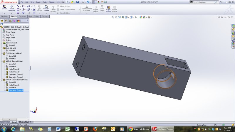

I'm very very new to solidworks. I have version 2013 Premium 64bit SP3. I'm in the process of going through some training using some videos I downloaded from the net. I draw very basic part currently with ACAD2014, rectangle parts mostly for machine products we manufacture. I was curious about SW so I started looking into it and now I like it. So here's my questions:
For practice only.
I created a part .88" wide by 1" high by 3.5" long.
I added a 3/8 NPT hole on the side of it. It did not show threads, only the hole size, type & depth. In ACAD I added some circle to the existing hole and then trimmed them to look like threads. Is there a way in SW to show threads? OR do I do the same as in ACAD?

Hello Stevsmith,
Thank you for the reply. I show All annotations checked. Drawing is attached.

It looks like you have two separate thread symbols on the hole feature. delete the one that you have highlighted. "Cosmetic Thread".

The hole in question is as follows:
The original drawing showed the hole to have a Counter-bore Hole of .375 dia .78 deep. Then the hole has a 3/8 NPT threaded hole at .44 deep. I'm trying to show the threaded hole with threads just for clarity. I've attached the drawing with the "Cosmetic Thread" removed.

Hello Stevsmith,
The problem was in the Options > Document Properties > Detailing that "Shaded cosmetic threads" was not checked.
