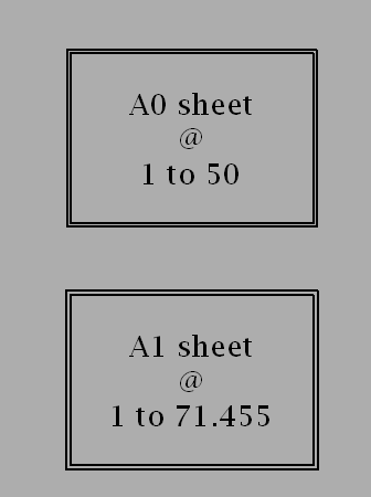

Jason Benzie Posted September 3 Share Posted September 3 Hello all. We have A0 master drawings @ 1:50. We would like to copy to A1 what would be the scale please? Quote Link to comment Share on other sites More sharing options...
fuccaro Posted September 3 Share Posted September 3 Since the size of A1 is half of the A0, the scale should be 1:100 Welcome in the Forum! 1 Quote Link to comment Share on other sites More sharing options...
Jason Benzie Posted September 3 Share Posted September 3 4 hours ago, fuccaro said: Since the size of A1 is half of the A0, the scale should be 1:100 Welcome in the Forum! A1 isn't half the size it's around 70 %, apparently, so I don't think there is an easy conversion Quote Link to comment Share on other sites More sharing options...
eldon Posted September 3 Share Posted September 3 2 hours ago, Jason Benzie said: A1 isn't half the size it's around 70 %, apparently, so I don't think there is an easy conversion There is not a simple conversion because of the edge framing line. This is at a constant 15mm (or so) whilst the whole sheet scales. My reckoning is 1:71.455, or choose a round number and order special scale rules. Quote Link to comment Share on other sites More sharing options...
BIGAL Posted September 4 Share Posted September 4 Try sqroot 2 is the ratio of metric sizes. They swap sides. "A1 isn't half the size it's around 70 %, apparently, so I don't think there is an easy conversion " (sqrt 2.) = 1.4142135623731 (/ 1.0 (sqrt 2.0)) = 0.707106781186547 A3=420x297 A2=594x420 A1 = 841x594 A0 = 1189x841 An A1 sheet to A3 size when plotted is a ratio of 50%. Quote Link to comment Share on other sites More sharing options...
