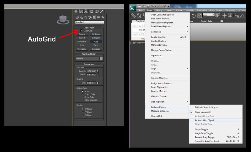

In Studio Max, if you want to use the Grid Helper to place a temporary workplane on the face of an object, you need to enable "AutoGrid" first. Then click on the face where you want the grid to be and drag out the grid. Then, with the grid still selected, go to the "Tools" menu > "Grids and Snaps" and click "Activate Grid Object".
Hope that made sense? :unsure:
Sorry it took so long to reply. Photoshop crashed on me twice while I was making the little graphic. Not sure what's going on there? :?
Ahhhh, gotcha! Thanks.... That gave me the ability to work on another plane in 3D View. Not as intuitive as Revit but hey, definitely gets what I need. Let me monkey around with this for a bit then I'm sure I'll be back for more.
