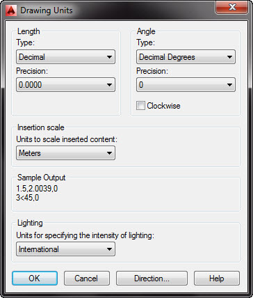

I set up a new page thus (I live in a country which uses metric units, so ...):
Then:

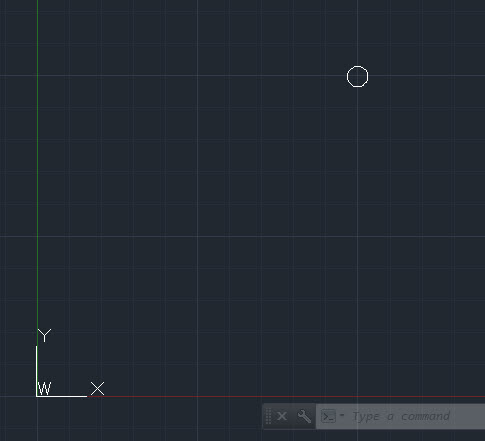

and I get:
The circle was centred at x=1000 metres, y=1000 metres, yet it displays right down at the bottom left of my screen. Compare the radius of the circle to the distance from the centre to the origin - it's nothing like 1:4! Look at the coordinates for the cursor!
Zooming in and zooming out has no effect on the huge dimensions indicated by the coordinates.

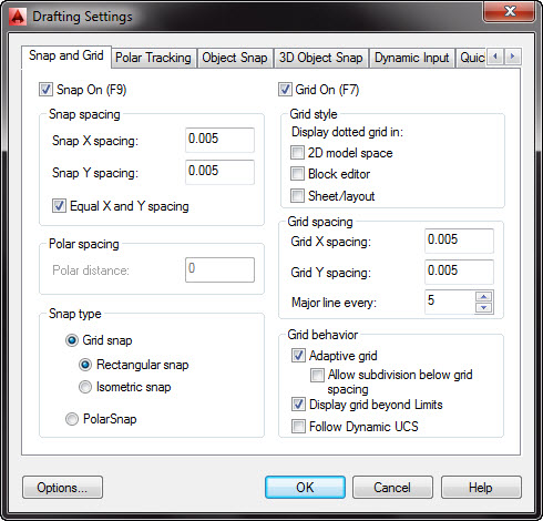

I went to Tools -> Options -> Drafting Preferences and adjusted the grid thus:
With Drawing Units set to metres:
that tells me that the grid should have minor spacing of 5mm and major spacing of 25mm. Yet, when I draw a circle with radius 25 metres (yes ... 25 metre radius)

Can someone please explain how that happens?
I don't know about you, Dana, but it's driving me nuts :shock:!!!
If the grid is 25mm on major lines and 5mm on the minor ones, how is it that a FIFTY METRE DIAMETER circle is represented as shown?

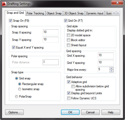

Still a little puzzled though. The Grid Settings are:
That's X & Y spacing at 10 with major line at 5. However in
which shows a circle with 25mm radius you can see that the grid spacings are 50mm. Now, I think this is terminological. Does the term "Grid Spacing" refer to an invisible grid to which the circle centre should "Snap"? I.e., where I see "Major line every 5" does that mean the lines on the grid (the light ones as well as the heavier ones) are separated by 5x10 Grid Spacings = 50mm?
the grid should have minor spacing of 5mm and major spacing of 25mm. [/i]
Drafting Settings -> Grid behavior -> uncheck Adaptive grid
That is exactly correct, remember that the drawing database units are now Metric instead of Imperial, and that the major grid lines which you are seeing are only 50 mm apart.
