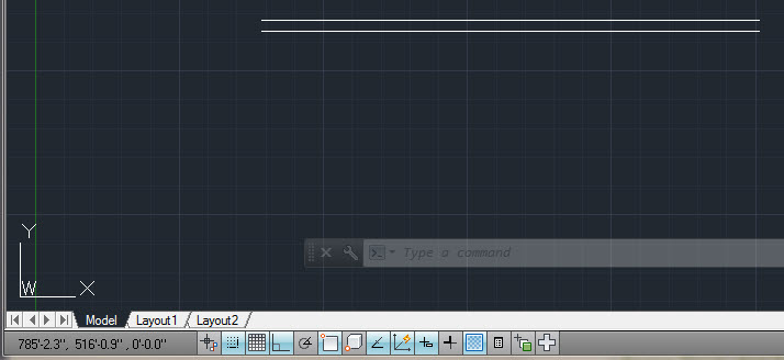

Start the Line Command (L + )
Pick the start point for the line
Pick the endpoint for the line
Start the Offset Command ( O + )
Specify an offset distance (either by picking two points with the mouse, or entering a distance)
Select the object to be Offset
Move the mouse to the side you want the offset to appear, and click
