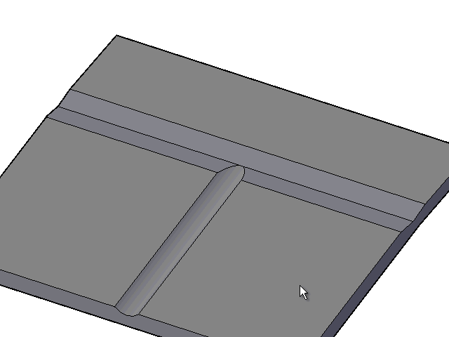

MargaritaErem Posted July 18, 2013 Author Posted July 18, 2013 Anything like this? [ATTACH=CONFIG]42983[/ATTACH] Wow! I guess I have a long way to go before I can do something like that. But no- that's not the cross section that I need. I need the depression on the side of the trail- so it's flat everywhere outside this semi-circular region. I am sorry that I still can't upload. I could have shown you my approximation with a subtracted cylinder. I am now trying to do the same technique but subtracting a sphere from a box. Thanks for the reply! Quote

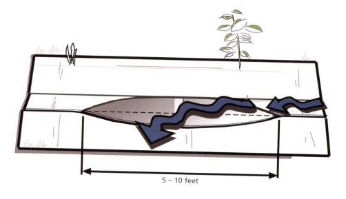

steven-g Posted July 18, 2013 Posted July 18, 2013 This illustrates the idea better. The image came from a document here which gives a good description. http://www.activevalley.org/SORBA/Examples%20of%20Normal%20Maintenance.pdf Quote

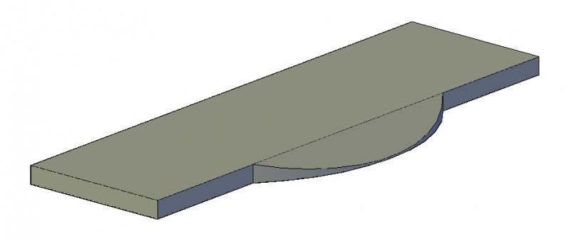

ReMark Posted July 18, 2013 Posted July 18, 2013 Would something like this rough approximation do? Quote

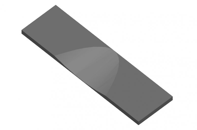

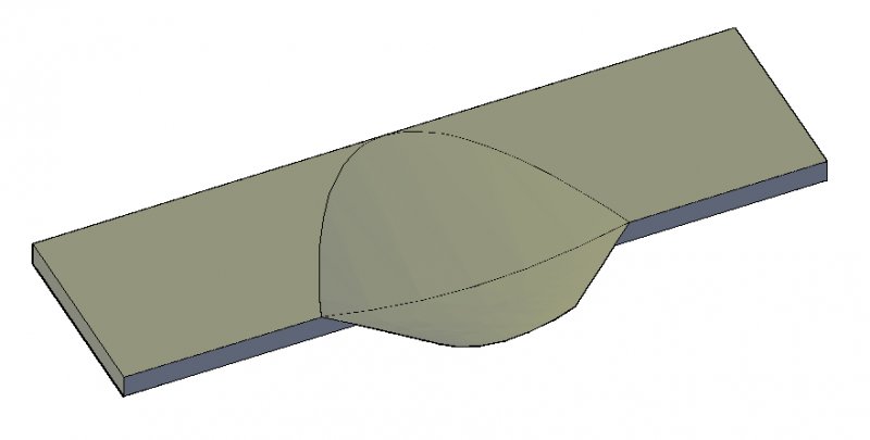

ReMark Posted July 18, 2013 Posted July 18, 2013 Still a rough approximation but might this be closer to what you are looking for? Quote

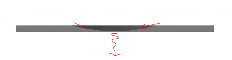

ReMark Posted July 18, 2013 Posted July 18, 2013 Front view of the previous idea. Kind of a scalloped affect. Quote
MargaritaErem Posted July 18, 2013 Author Posted July 18, 2013 THANK YOU REMARK! It took me a long time last night but I got something that is very close to the third drawing that you posted. It has a lip that leads to a side ditch which, I am proud to say, I also managed to create. Thank you for all the effort you put in your replies! Even one visit to this forum really helped me! -Margarita Quote
