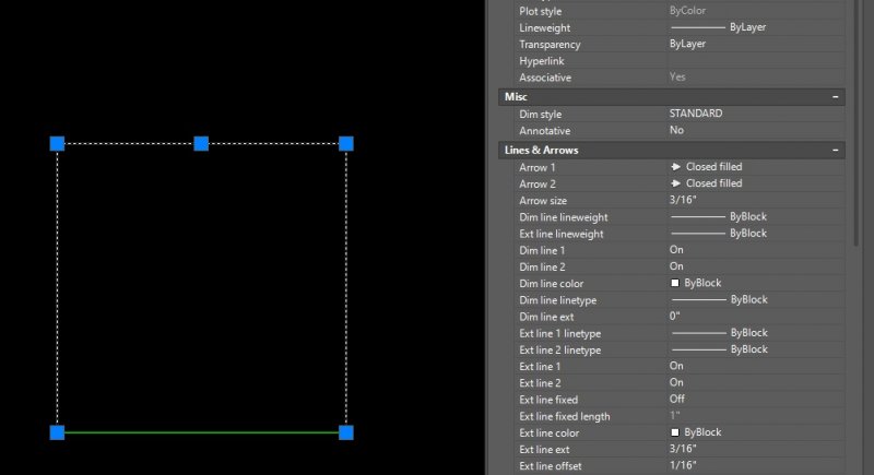

Thank you for your input! It made me go back and look at my approach. I noticed I was forgetting something
code below works with an existing dimension that's not already associative
(defun c:Dassoc ( / _dimension _object _extensiondictionary _dimassoc _number _list )
 (if
   (and (setq _dimension (car (entsel "\nSpecify Dimension: ")))
     (or (wcmatch (cdadr (setq _dimension (entget _dimension))) "*DIMENSION*")
        (alert "You must select a dimension to continue!")
     (setq _object (car (entsel "\nSpecify line associate with: ")))
     (or (wcmatch (cdadr (entget _object)) "LINE")
        (alert "You must select a Line to continue!")
     (setq _extensiondictionary
       (handent
         (vla-get-handle
           (vla-getextensiondictionary
             (vlax-ename->vla-object (cdar _dimension))
     (setq _dimassoc
       (entmakex
         (list
           (cons 0 "DIMASSOC")
           (cons 100 "AcDbDimAssoc")
           (cons 330 (cdar _dimension))
           (cons 90 3)
           (cons 70 0)
           (cons 71 0)
           (cons 1 "AcDbOsnapPointRef")
           (cons 72 1)
           (cons 331 _object)
           (cons 73 13)
           (cons 91 3)
           (cons 40 1.0)
           (cons 10 '(0.0 0.0 2.0e+050))
           (cons 75 0)
           (cons 331 _object)
           (cons 72 1)
           (cons 73 2)
           (cons 91 3)
           (cons 40 1.0)
           (cons 75 0)
     (entmod
       (append (entget _extensiondictionary)
         (list (cons 3 "ACAD_DIMASSOC") (cons 360 _dimassoc))
     (setq _number (vl-position (assoc 330 _dimension) _dimension))
     (repeat _number
       (setq _list (cons (nth (setq _number (1- _number)) _dimension) _list))
     (entmod
       (append _list
         (list '(102 . "{ACAD_XDICTIONARY") (cons 330 _extensiondictionary) '(102 . "}")
           '(102 . "{ACAD_REACTORS") (cons 330  _dimassoc) '(102 . "}")
         (member (assoc 330 _dimension) _dimension)
 ) (princ)
