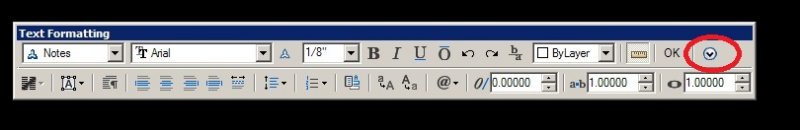

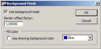

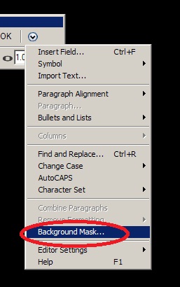

AFAIK you need to use the Text Editor>Options>Background Mask, just double-click the text portion.
... or if using the Ribbon, the Contextual Ribbon State (double-click) for MText has a "Background mask" button which pops up the same dialog box as the last image in SLW210's post.
