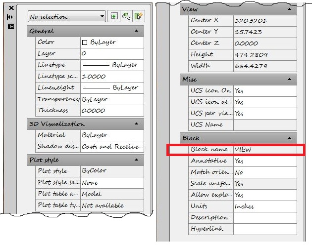

Open Your Block in block-editor and in the properties palette u will be able to see the "Annotative" option, make it "Yes":glare:
Note: (don't select any object inside of the block, then only u will be able to see the main properties of the block)

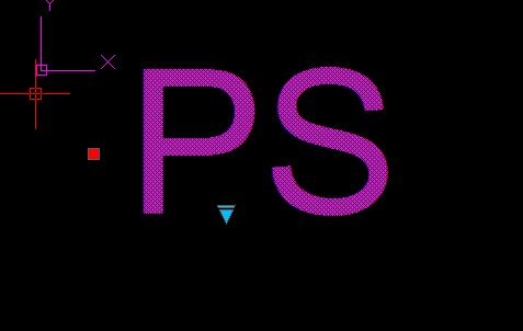

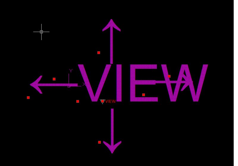

My Block when Opened:
Properties Palette:
My Block After Changing The Annotative Property To "Yes":
Notice The other grips which were present before, has disappeared. Problem Solved.
