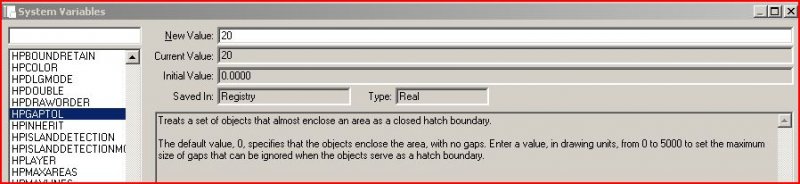

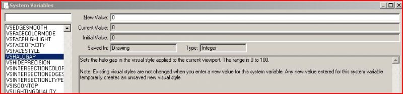

Hi, is it possible to get your Gap Tolerance setting to stick. Mine keeps reverting to 10 by default!?
To which type of gap tolerance are you referring?
... or Hatch gap tolerance (HPGAPTOL) ?
Good point nestly, I bet that is the one in question, as it is probably
the most useful of the three. :beer:

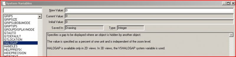

Wasn't this previously called HALOGAP?

So i was talking about the Hatch Gap Tolerance......
Anyone else find it keeps defaulting?

I am using a custom template
The HPGAPTOL is stored in the registry, so perhaps you're running a lisp or macro or something that's changing it.
If you use an ACADDOC.lsp, you can add this piece of code (setvar "HPGAPTOL" 0) If that doesn't work, then you're loading another custom command or lisp that's changing the gap tolerance.
cheers for that! i shall give it a whirl :)
