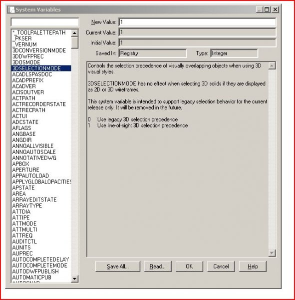

Dadgad Posted July 11, 2013 Posted July 11, 2013 Oh I totally agree! I am not disagreeing, I actually thank you for your comments and valuable input. I just fear that by resetting the profile it will basically "forget" everything we have been repairing, or "tailoring" to how we like things and how we do things... What do you think? I can save down a current copy of my profile but that doesn't necessarily carry EVERYTHING over from this station... I just would hate to have to spend a half day retyping variables and setting the station back up to how we have it now. But I do understand your philosophy on a quick reset how "most" of the time that solves the solution. I just wish we could pin point this issue Enter SYSVDLG and hit ENTER. At the bottom of the dialog box you will see the button to Save All, as an .svf (system variable file) to assist you in resetting your variable settings should you need to, It is always a good idea to have it, because things just have a way of happening. Quote

tmelancon Posted July 11, 2013 Author Posted July 11, 2013 Hey Dadgad, Thanks for that reminder! I tweaked a bunch of variables and stuff and completely disregarded the fact that there is a SAVE ALL button. I guess this is what happens when you have a zillion things going on at once at the office! PROPS! Quote
