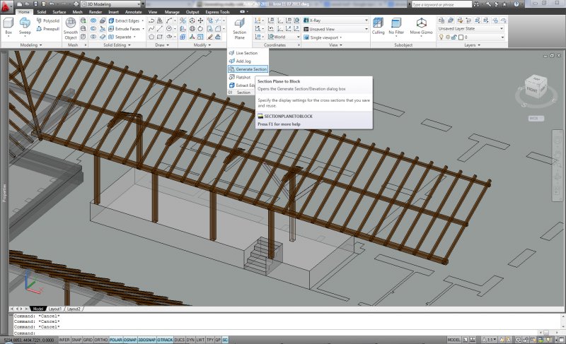

I have modeled a house. It consists of a number of elements created on different layers with different colors. When I generate a section block it is only in one color, this makes it hard to distinguish different elements. Manually changing the colors of each line is out of the question.
How can I generate a section witch keeps the colors of the elements defined by the color of the layer which they occupy?

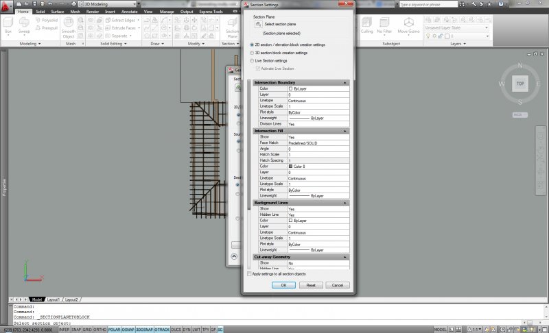

I'm confused as far as the settings go in the generate section menu. The color/linetype, i tried changing them around, but seen no change = = = > confusion :?
Can anyone post a pic showing how it should be set up to get the desired result?

What command are you using to generate this section?
Hmmmmm, I'm using the generate section cmd, from the section tab, I did not realize there are more ways of generating sections.
Here's a pic
Ah...the SectionPlane command.

Do you have a solution, or a suggestion for my problem? Part of what I'm foing a section-plane is in the background.
Patience is a virtue. I'm thinking on it.
Dadgad's advice works. Just tested it myself. There's just one problem though...you end up with the base geometry and solid hatches.
BTW...Flatshot does not give you a section option although it's possible to edit the 2D block one does get to give the appearance as such and in the process change the assigned colors. The block that is initially created can have a different color/linetype for the foreground lines and for the obscured (hidden) lines.
ViewBase might work but you would have to export the block back into model space from paper space where it is placed by AutoCAD.
I'm almost positive I have seen what you want to achieve but haven't done it myself. Or....I'm dreaming and never saw it done at all.
Are the settings correct?
