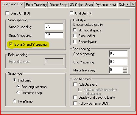

Isn't there an EQUAL X AND Y SPACING option in the dialog?
Might it be enabled?
I know the attachment is not the dialog box with which you are working,
I am on Autocad Vanilla,
but like this perhaps?

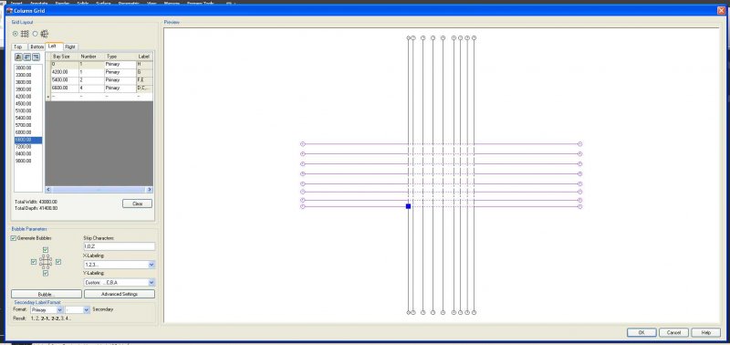

Sorry but it seems you've misunderstood. I'm speaking about the enhanced custom grid found on the home tab not the standard grid snap setup. See jpg screenshot.

What program are you using? Is it AutoCAD Architecture by any chance?
Can't you edit the lengths via their grips?
From your Help file...
Tip You can also change the size of a grid by dragging its grip points. When you have a manual grid, you drag the individual lines, and not the grid.
Seems the primary extensions for gridline length for Left, Right, Top, and Bottom is done with the Advanced button, but I think the final adjustments (including bubbles) are grip edits after the grid is placed. I only have 2013 installed, but it seems to follow this demo using 2012
