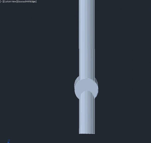

Hi,
Is there away to trim the diagonal 3d solid to the top of the horizontal 3d solid in the picture.
Thanks

Are the centerlines of both cylinders at the same elevation? Something looks a bit off.
I would use the INTERFERE command, then SUBTRACT the "interference" object, then Separate the two halfs.
Heres a demo -->
...or for 3 dollars, you can get the TRIMSPLIT app/plugin from Autodesk Exchange to automate the process. http://apps.exchange.autodesk.com/ACD/en/Home

I tried this but for soe reason it doesnt detect the part of the solid that is 'inside' the other. i use the interfere command and select the bottom side of the diagonal solid and then when i window across like in your video it wont select anything.
