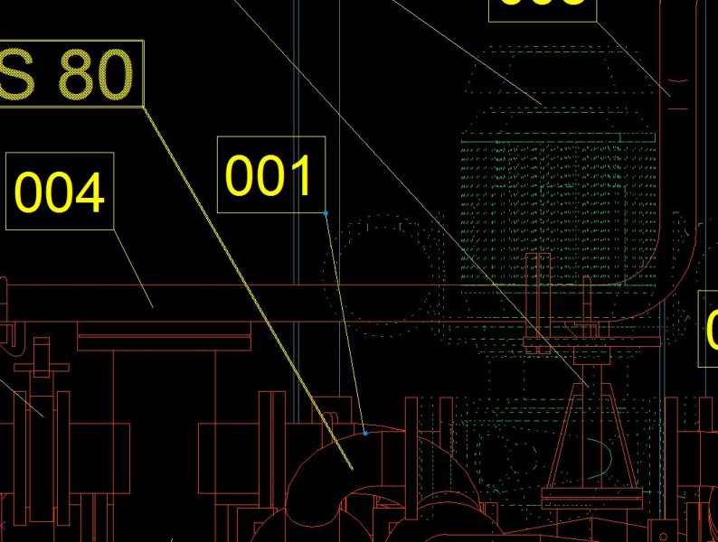

Guys, i recently upgraded to acad2012.
now the problem is the polyline, the polyline when moved in contact with other object it gets stuck to its points. and when i try to move only the polyline the object moves along with the polyline. :itsover:
how to disable this:wacko:
pic:
Constraints is not a new feature but it is one that seems to plague a lot of users as it seems, for some reason, it is enabled from the start when in fact most of us would prefer it be disabled.
