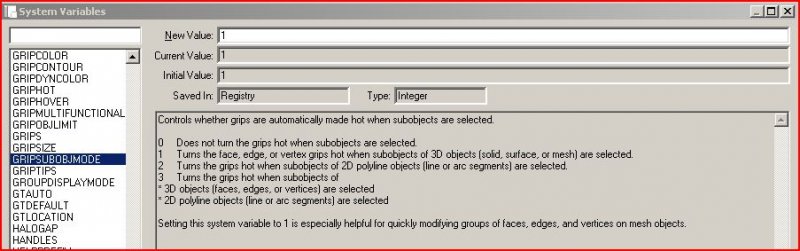

Dadgad Posted July 9, 2013 Share Posted July 9, 2013 This describes one of the SYSTEM VARIABLES which controls selection behavior. If you click on the TUTORIALS link at the top of the page, you will be able to find plenty of tutorials to help you. Quote Link to comment Share on other sites More sharing options...

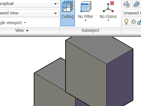

nestly Posted July 9, 2013 Share Posted July 9, 2013 I's x-ray... The grips are visible, but non select-able... In 2D wireframe it works just fine. Why is that? Try turning off Culling Ribbon > Home > Subobject > Culling Command line: CULLINGOBJ = 0 Quote Link to comment Share on other sites More sharing options...
