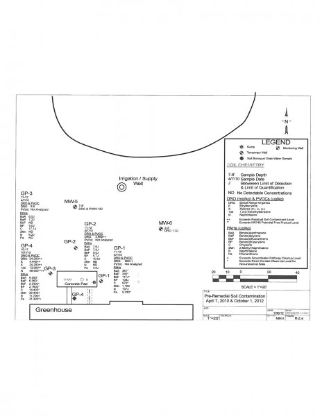

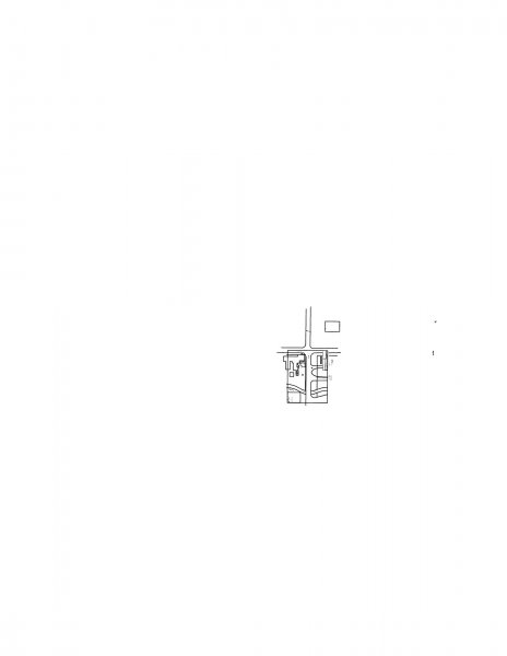

skf drawing.jpg Ok, I think I got it? The tiny one is supposed to be 1"=30' scale. It's the one that I converted from .skf to .dwg. The other one is an AS map, nothing done to it in CAD.
I THINK I'm working in the model space and a viewport? I keep jumping from the model tab to the layout 1 tab.
To convert the files I do a save as .dwg rather than .skf

Go to your layout.
Type the word SCALELISTEDIT. Press the Enter key.
Click on the Add button on the left.
For the name of the scale type 1"=30'-0".
For Drawing Units type 360.
Click the OK button.
Let me know when you have done that.
It should look like this before you click on the OK button.

Go to your paper space layout.
Open the Properties palette.
Left click on your viewport.
Look on your Properties palette and find where it says Standard Scale.
Click on the arrow to the right. A scalelist should appear. Select the new scale you just created.
The viewport should now have a scale of 1"=30'-0" assigned to it and your model space objects will appear to have been resized.

Ok, I THINK I have the scale changed. Now how, or at least what terms should I look up to find the answer should I use to move the image to the "print area"?
And for what it's worth, I do appreciate the help.
Move the image to the print area? Not sure what you are asking.
If the plot plan is not located within the viewport as you would like you would have to click inside the viewport to activate it. Then you could use the PAN command to reposition your view of the model space objects. After doing so you may have to reenter paper space and adjust the size of the viewport via the "grips" at the corners one sees when the viewport is selected. Finally, I would suggest that you right click on the viewport and look for the "Display locked" option and set this to "Yes". Why? Because it keeps you from inadvertently changing the viewport scale which should still be set to 1"=30'-0".
