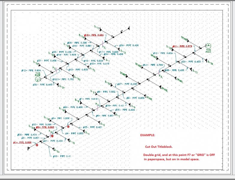

I draw with 8"x11" templates with limits set to the 8x11 titleblock we use and the grid is always set to dots. I notice that sometimes, not all the time, in model space and/or in paperspace there is an additional set of grid with limits but it is offset from my limits and my titleblock template? Then if I switch layouts or from PS to MS then back it will be gone. HELP! PLEASE! Even though it eventually goes away it drives me nuts because I want it GONE FOREVER!
MY GRIDDISPLAY is set to '0'.
MY GRIDSTYLE is set to '3'
I have Adaptive grid off
I have DISPLAY GRID BEYOND LIMITS - OFF so that is another main reason I am curious why ANY grid or ANY limits would appear beyond my own set limits and my own set grid within my titleblock.

To answer your question, when I go into paperspace my grid is ALWAYS OFF but I still see "double grid", because its like two sets of dots on the layout. Any ideas?

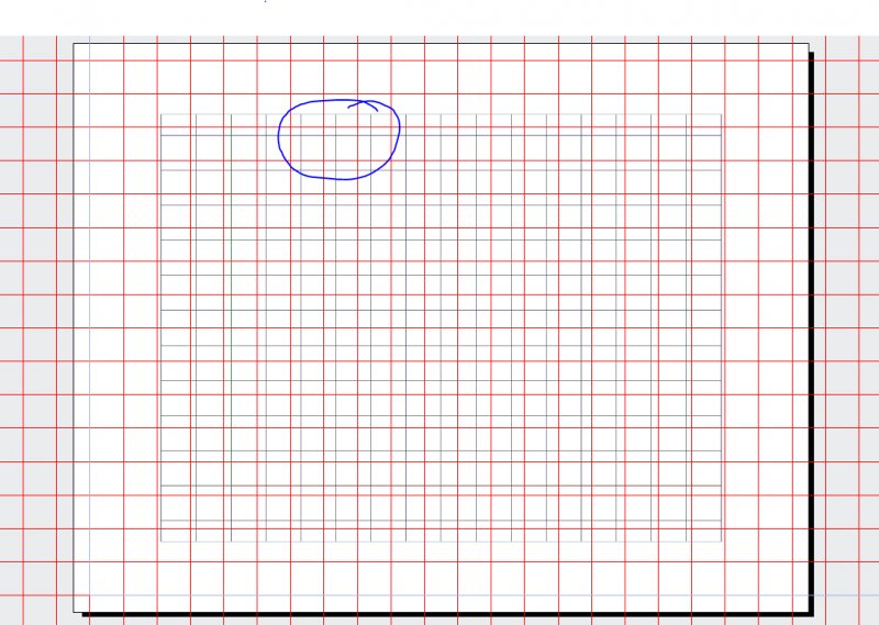

How's this for a double grid? The red one is in paper space. Neither grid was drawn. I used the native GRID command.
Now ask me which template I used.

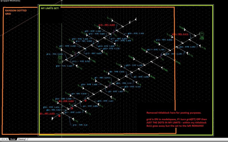

Here is two snipits maybe this will better explain and show my dilemma..
the most random thing, its like where are the dots coming from, out of space limits? something i dont know about... thanks

Hey guys here is an attached drawing. This is the template that I use. Any discussion and input helps, I may just be overlooking something. Thanks:geek:
Again, grid is off in paperspace but the dot grid shows up and its extents are the viewport? Strange because when I toggle grid 'ON' in paperspace, the grid was never customized, so it is still the factory blue grid.
I also recently noticed that if I regen or regen all you will notice the 'strange' grid resetting depending on how far or close you are zoomed in. Give it a try and get back if you can.

UPDATE:
I noticed a work around and maybe you guys can go off of this to find the root cause and share your knowledge to help me out.
When I open the template and click my Drawing1 paperspace tab, I double click into my viewport (._mspace)... IF I turn my grid OFF(F7) in that viewport model space then hit ._pspace to bring me back to my layout the grid is gone, when I tab over to my model space tab my grid is still there and the RE, REA, R regenerate commands no longer show the strange DOTTED GRID!!!!
I would say SOLVED! but I no longer see my DOTTED GRID in layout, which is no big deal because I do nothing with it in layout besides plot, but it obviously means that there is still something that I cannot figure out because this is the first time we have experienced this ever!!
If someone takes a look at the drawing template I attached I would love to hear your thoughts. Thanks
