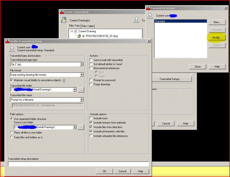

DashaB Posted July 1, 2013 Posted July 1, 2013 Etransmit will create a zip file which will have (depending on your options selected) either the working file and xref files referenced to the .zip, or it will bind the xrefs to the working file. Etransmit can also include text files, attachments in the forms of .tiff and .jpeg. again, depending on the options you choose. Just e-mail the .zip file created (it will ask you where you want to save it and where), and that should have everything they need. Quote

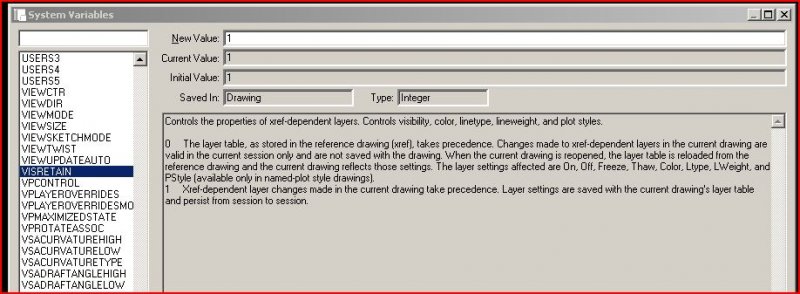

jaredmccullough Posted August 16, 2013 Author Posted August 16, 2013 Ok I understand the ETRANSMIT now I am running into issues. I am trying to tidy up the XREF drawings, the individuals whose drawings these are added a couple layers that are colored and for my purposes distract from the drawing. I asked him to turn them off so I could make an ETRANSMIT and send it out to a consultant. By theory because these are XREF drawings they should update when he changes his drawings. That is not happening though, I have also tried the reload feature for the XREF drawings. Any thoughts Quote
RobDraw Posted August 16, 2013 Posted August 16, 2013 Change visretain to "0" or manually make the change to the XREF layer in the base drawing. Quote
Dadgad Posted August 16, 2013 Posted August 16, 2013 When you start the Etransmit, a dialog box will open, wherein you have lots of different options. Binding is an option available in the Transmittal Setup, not a default behavior, use the Modify icon to access all options. The Etransmit can take a few different forms .zip is probably the most common, but self extracting executable (.exe) or folders are a couple other choices. Click on the dropdown menus to understand all your options. Quote
jaredmccullough Posted August 16, 2013 Author Posted August 16, 2013 Thank you Rob Draw what exactly does setting the VISRETAIN to 0 do just for my own knowledge? Quote
Dadgad Posted August 16, 2013 Posted August 16, 2013 As shown in the image from your SYSVDLG ... I believe you want to set it to 1. Quote

jaredmccullough Posted August 16, 2013 Author Posted August 16, 2013 As shown in the image from your SYSVDLG ... I believe you want to set it to 1. I agree with what your saying but in relation to what you posted I am actually not making any changes to the XREF layers I am just using them as a "Picture" to build on top of so would that make a difference and how?????.......... Quote

RobDraw Posted August 16, 2013 Posted August 16, 2013 I agree with what your saying but in relation to what you posted I am actually not making any changes to the XREF layers I am just using them as a "Picture" to build on top of so would that make a difference and how?????.......... Changing the color of a layer IS making a change. That's what we are talking about, changing the layer properties, yes? Quote
jaredmccullough Posted August 16, 2013 Author Posted August 16, 2013 Changing the color of a layer IS making a change. That's what we are talking about, changing the layer properties, yes? I have all layers that are referenced in filtered so I am not able to see or make changes them. I understand what changing the layer properities is but the only layers I make any adjustments to are the layers that were created in the drawing I am using (Not any XREF drawings). And how does the VISRETAIN Setting affected this am I alright on "0". Quote
