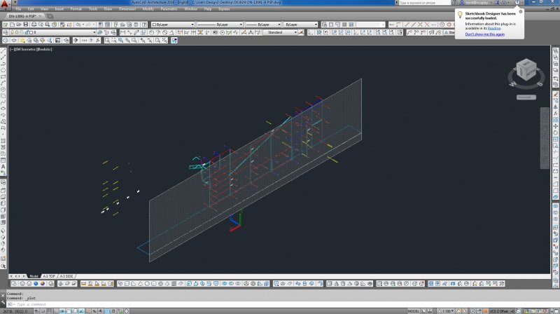

bartk1 Posted June 26, 2013 Posted June 26, 2013 Hi All, I have a big issue with section plane in AutoCAD Architecture 2014. Im trying to use boundary section plane on a steel construction. Everything is working well untill I press ctrl+s to save or save it in anyother way than I get message: Command: Command: _qsave Updating Indexes for block *Model_Space Done. Updating Indexes for block *Model_Space Done. The Boolean operation on solid and/or surface bodies failed. Modeling Operation Error: Inconsistent face-body relationships. The Boolean operation on solid and/or surface bodies failed. Modeling Operation Error: Inconsistent face-body relationships. The Boolean operation on solid and/or surface bodies failed. Modeling Operation Error: Inconsistent face-body relationships. The Boolean operation on solid and/or surface bodies failed. Modeling Operation Error: Inconsistent face-body relationships. and my drawing is messed up. regen of the drawing is not helping. What I need to do is: -Turn off live section -save as new file in 2010 version -regen -turn section plane back on Its more than anoying to use it this way. The last good working version of Autocad that I didnt had problems with is 2011. Section plane was working there without any issues. Quote

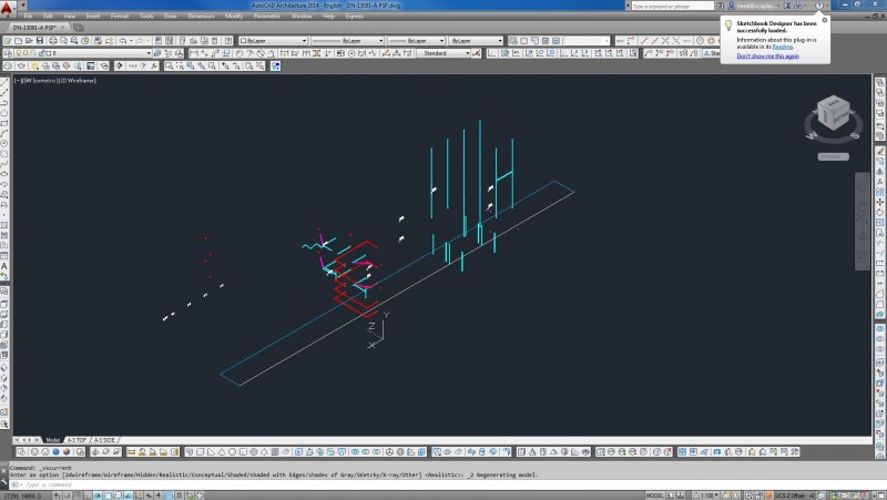

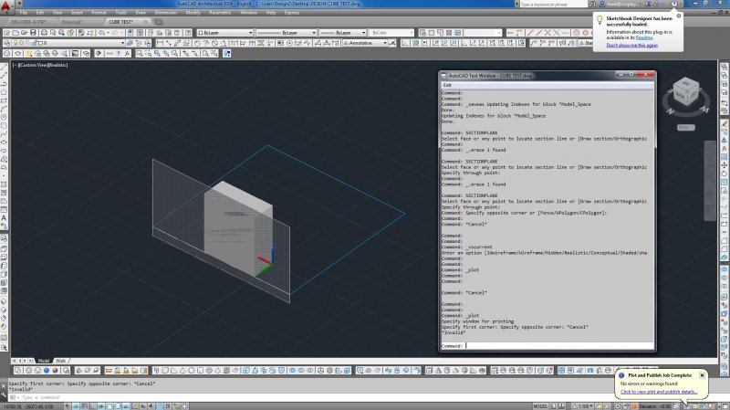

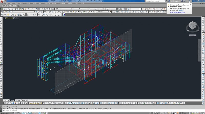

bartk1 Posted June 26, 2013 Author Posted June 26, 2013 Me to but .... its not. image 1 - thats my drawing that I need to get section plane from Image 2 - Still doing good I can see my section and export it and whatever. Image 3 - I presed ctr+s to save it and thans **** hits the fan. + message : The Boolean operation on solid and/or surface bodies failed. Modeling Operation Error: Inconsistent face-body relationships. The Boolean operation on solid and/or surface bodies failed. Modeling Operation Error: Inconsistent face-body relationships. The Boolean operation on solid and/or surface bodies failed. Modeling Operation Error: Inconsistent face-body relationships. The Boolean operation on solid and/or surface bodies failed. Modeling Operation Error: Inconsistent face-body relationships. The Boolean operation on solid and/or surface bodies failed. Modeling Operation Error: Inconsistent face-body relationships. The Boolean operation on solid and/or surface bodies failed. Modeling Operation Error: Inconsistent face-body relationships. Any good idea why ? Image 1 and 2 are swithed - no ide why (SORRY) Quote

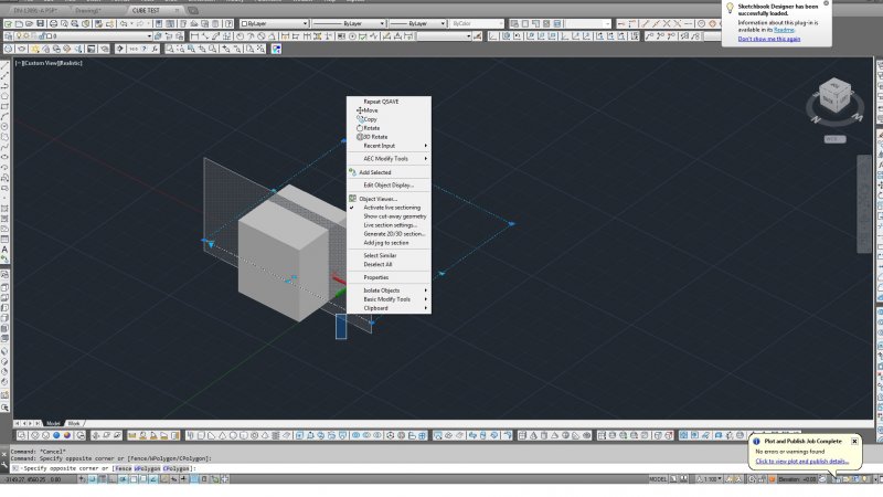

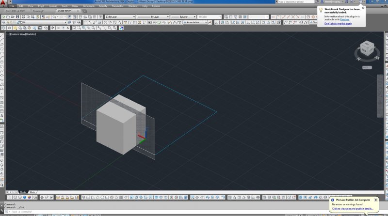

bartk1 Posted June 26, 2013 Author Posted June 26, 2013 CUBE TEST.dwg I cant share my work . . . but i can make a simple drawing with solid and maybe I can show you what happend with it at my company, and we can see if you will have the same problem as I have. At my office works 2 other designers and we all have the same problem. Please let me know or send me back file that you made. Picture 1 cube with deactivated section plane Picture 2 cube with activated section plane picture 3 cube with activated section plane after save Quote
