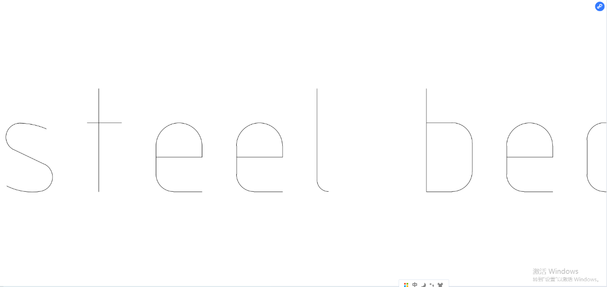

lamensterms Posted June 26, 2013 Posted June 26, 2013 Hey guys, Just a quick one - hopefully someone will be able to set me straight pretty easily. When I print PDFs using the AutoCAD PDF creator (DWG to PDF.pc3).... I get a pretty nasty representation of the text within the DWGs (see attached image). Does anyone know of a setting or a workaround which would enable better quality PDF production? Thanks so much for all your help. Quote

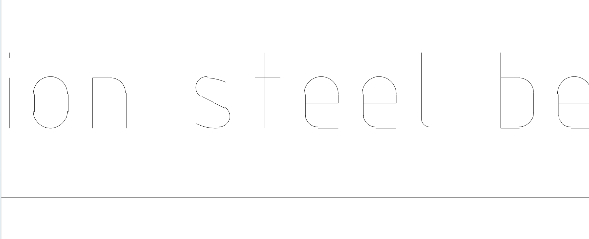

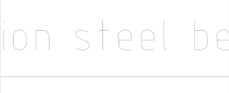

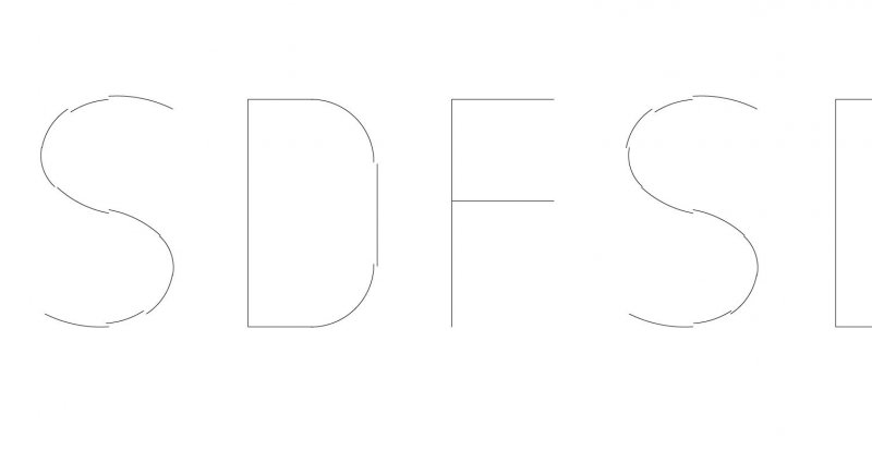

lamensterms Posted June 27, 2013 Author Posted June 27, 2013 Hi guys, Thanks a lot for the replies. Please find attached a DWG which exhibits the poor quality PDF production (in fact – all our drawings have the issue). I have also attached 2 PDFs – one which was created with the DWG to PDF PC3 file, and one which was created with PDFCreator (which has no distortion). DWG to paper print is fine – no distortion on any font at any scale. PDF to paper print is distorted. The distortion can easily be seen on a paper print of the PDF. The text is lined up with the viewport. The drawing is in model space but it is 2D (I consider it to be a 2D drawing even though the model space is potentially 3D). Would that be correct or would you consider any drawing which is in model space to be 3D? The font name is isocp.shx. But that is not the only font which has the issue. I have attached an image of the distortion shown with the font ISO3098B.shx as well. It seems any ‘line’ font might have a problem. Thanks again for your help guys, I look forward to hearing back. Text Test (DWG to PDF).pdf Text Test (PDFCreator).pdf Text Test.dwg Quote

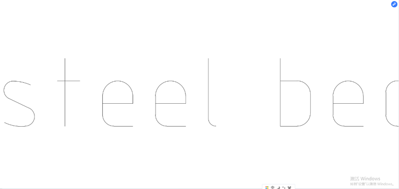

lamensterms Posted December 6, 2013 Author Posted December 6, 2013 Hey guys, Just wanted to follow up on this as a few months have passed. I am still seeing the issue. I have since moved to a new machine with a new(er) version of AutoCAD and am still seeing the jagged lines. I have found this thread: http://www.cadtutor.net/forum/showthread.php?66159-Fillet-lines-are-off-from-straight-lines-on-PDF/page2 But there doesn't seem a be a real solution posted there. Just wondering if anyone has come across anything since the last discussion. Thanks guys. Quote

lamensterms Posted November 22, 2023 Author Posted November 22, 2023 Hi eric My solution ended up being to increase vector resolution in the PC3 file. Is that what worked for you? Quote
