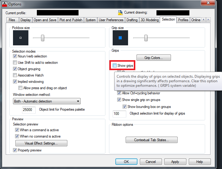

Anyone know how to get rid of this garbage in the attached picture? I remember when it was only Ustation that caused this grief. I guess autodesk decided to catch up

Here it is. Call it up and hit CTRL-A. All of the flotsam and jetsam will show up. If you use a window it won't show. This junk is invisible but it is there and it slows down the computer.
HANDLES.dwg
The blue handles you're having an issue with, are grip handles of the selected entities, which show when you Ctrl+A based on your other system settings.
To manipulate this functionality, simply modify the Show Grips setting of the Selection tab, in the Options dialog:
... Or look into the GRIP* System Variables as needed. :thumbsup:

Probably because GRIPOBJLIMT is set to something normal, but did you check the number of entities after selecting everything?
I'm finding 2.8K + empty block references spread out all over the place. Block Name "AE" accounts for most of them, but 57 named "NEWLAYERSETUP" which probably means something to the OP.
You have blocks that are attributes without any geometry throughout the drawing. Since the attributes don't have a value or a default value and there is no geometry associated with them they don't show. I would block out the geometry that does show and insert in a new drawing.

Yes! I could care less about the grips showing up. My problem is that there presence causes the program to run slow. My cursor doesn't move smoothly but rather jumps making it hard to select anything when the drawing is laden with this junk.

What I feel you may not be understanding fully, is that the grips being displayed have a direct result on the performance... Again, as the small 'bubble' information in the image I attached earlier clearly states:
... Displaying grips in a drawing significantly affects performance. Clear this option to optimize performance. (GRIPS system variable).

Ctrl+A will select everything, including these phantom items. Holding Shift+Select everything will deselect all objects and leave the phantom objects selected. Deleting them, and running a PURGE and -PURGE with RegenApps will rid the items.
