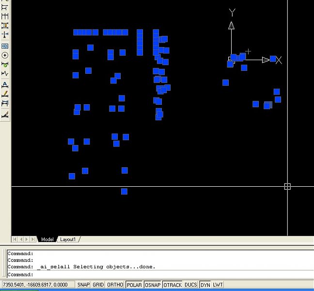

alijahed Posted November 19, 2008 Posted November 19, 2008 Hi All, I've attached a blank drawing which has a block. but it's hiding somewhere and I can't find it and I don't know how to remove it. If you want to see that block you can find it in Insert>Block or Design Center. The other thing is, how can I get rid of those two Layers (ASL_Text and ASL_Dim). maybe those layers are using in that block! That's really annoying:cry: Cheers Ali 1.dwgFetching info... Quote

nocturne00 Posted November 20, 2008 Posted November 20, 2008 Ok your file has got me stumped but i did manage to get around it. set your MLEADERSTYLE to standard, and then purge the STD. then you can now purge the detailcallout block. i dont know how they are linked but that seems to have done the trick Quote
wizman Posted November 20, 2008 Posted November 20, 2008 i had a look at your drawing, you got 24 blank mtexts, 72 blank texts(in layer ASL_text), 1 blank hatch and 1 paperspace vport (in layer asl_dim) and no insert of that block, but still i was not able to purge that block and vport. Quote

nocturne00 Posted November 20, 2008 Posted November 20, 2008 QUICKSELECT; try to zoom out in MS first. in the dialog box drop down the Object Type and you'll see the present entities (w/c in your drawing has Mtext, Hatch and Text entities). or you could do a select all (CTRL+A) Here's a screen of your file in MS Quote
alijahed Posted November 20, 2008 Author Posted November 20, 2008 I don't know why! on mine it found 97 objects but it appears as a one blue point! nocturne00 said: QUICKSELECT; try to zoom out in MS first. in the dialog box drop down the Object Type and you'll see the present entities (w/c in your drawing has Mtext, Hatch and Text entities).or you could do a select all (CTRL+A) Here's a screen of your file in MS Quote
nocturne00 Posted November 20, 2008 Posted November 20, 2008 alijahed said: I don't know why! on mine it found 97 objects but it appears as a one blue point! Check your GRIPOBJLIMIT Variable, maybe its set to 1. i cant think of any other variable for controlling grip numbers Quote
