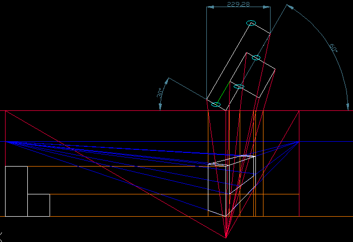

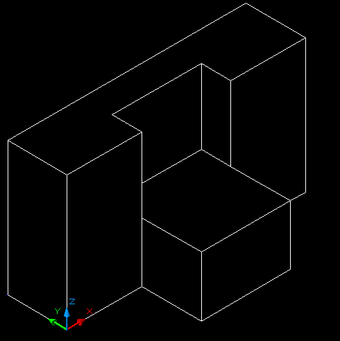

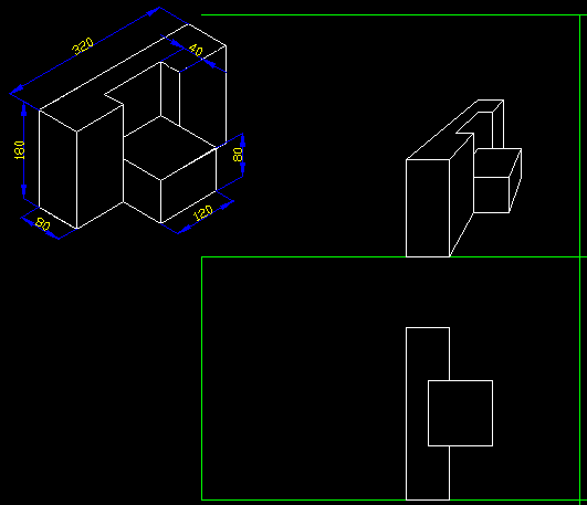

BillyWonka Posted June 22, 2013 Share Posted June 22, 2013 Here's the task: The figure in 3D: What I've done so far: I'm stuck at this stage. Quote Link to comment Share on other sites More sharing options...
ReMark Posted June 24, 2013 Share Posted June 24, 2013 Two days and no responses? Let's give this thread a *bump* and see what happens. Quote Link to comment Share on other sites More sharing options...
neophoible Posted June 24, 2013 Share Posted June 24, 2013 Some of you architectural types need to help here. But I will start off, just to see if I can help a little. In the 2-pt, it appears you are confusing the projection of the two blocks. The blue line on the right should be coming off the back right corner of the large block, rather than from that of the shorter block. Quote Link to comment Share on other sites More sharing options...

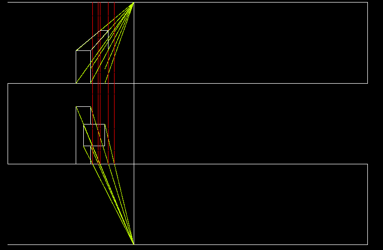

BillyWonka Posted June 25, 2013 Author Share Posted June 25, 2013 I did 1-pp drawing but it looks very odd. Can someone verify if it is OK or I made a mistake? 1-POINT PERSPECTIVE.dwg I still have trouble with 2-pp drawing. I've tried various tutorials but I don't understand how to get that specific shape of the box in the middle. I'd really appreciate if someone helped me out with this one. 2-POINT PERSPECTIVE.dwg Quote Link to comment Share on other sites More sharing options...
neophoible Posted June 25, 2013 Share Posted June 25, 2013 I was hoping some with real know-how would chime in here, and maybe they still will. I can't help you much, but I can tell you that, for projecting the tall box, including its notch, you need to project from the edges of the tall box, not from those of the short one. Try projecting using the edge points I've marked here. Quote Link to comment Share on other sites More sharing options...
rkent Posted June 25, 2013 Share Posted June 25, 2013 I did 1-pp drawing but it looks very odd. Can someone verify if it is OK or I made a mistake?[ATTACH]42619[/ATTACH] [ATTACH=CONFIG]42620[/ATTACH] I still have trouble with 2-pp drawing. I've tried various tutorials but I don't understand how to get that specific shape of the box in the middle. I'd really appreciate if someone helped me out with this one. [ATTACH]42621[/ATTACH] [ATTACH=CONFIG]42622[/ATTACH] The one point looks pretty good, you are missing one line on that inside corner. For the two point, lower box, you have to find intersections and project lines from known intersections to find other intersections. See attached, hopefully it will help. perspective 062513a.dwg Quote Link to comment Share on other sites More sharing options...
