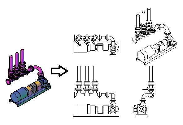

In AutoCAD, it's extremely easy to create details of assembled parts from the 3D model (below left) by using either FLATSHOT or Drawing Views (below right). Neither of these tools appear to work on AEC content, so what are the options to convert the MEP parts/equipment into 3 or 4 isometric views that can be dimensioned and shared?

Even though I'm not thrilled about the extra steps, EXPORT / FLATSHOT is probably the only option because I usually want detail and flexibility that isn't available through Drawing View or Sections.
