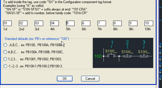

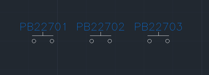

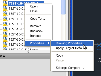

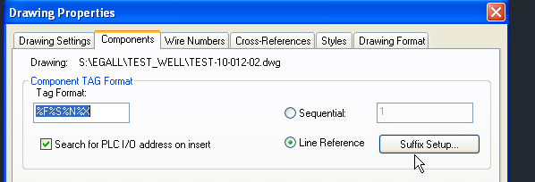

gallagej Posted July 10, 2013 Posted July 10, 2013 1. open your drawing properties click on the Components tab then clik on suffix setup if you add a 0 in front of the number you should get the result you are looking for Quote
