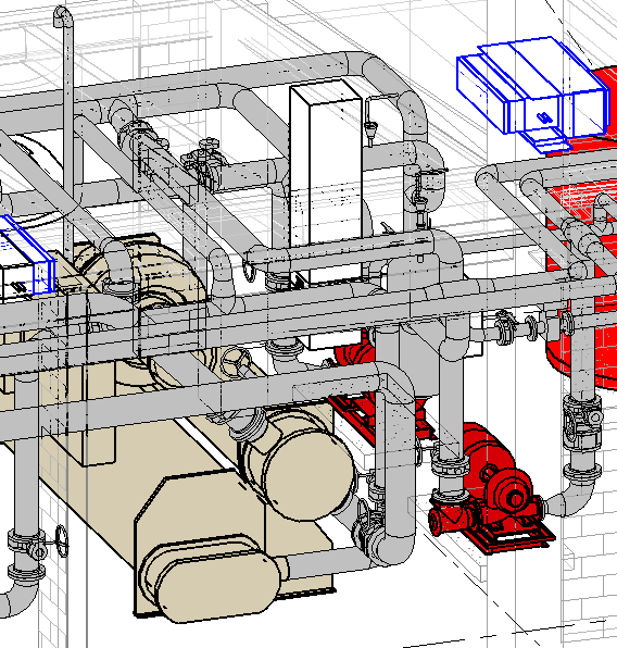

tzframpton Posted June 19, 2013 Posted June 19, 2013 (edited) Gloating a bit here. Just made this Detail Component Family and thought I'd share. This works good for detailing Piping Components and not having to physically model every flanged flexible connector. Line-based Family with nested Slip-on Flange Detail Components. Hope someone finds this useful. Enjoy!! *EDIT* Family has been updated. Now has Weld Neck Flanges, and Visibility Parameters to toggle either mating flange, or have them turned off. Metail Braided Flanged Flexible Connector Family Edited June 20, 2013 by tzframpton Quote

tzframpton Posted June 19, 2013 Author Posted June 19, 2013 Screencast: Unable to display content. Adobe Flash is required. I am showing three parts. First, the parent Family that contains the nested Family. Then I show the Slip-On Flange Family and how it flexes parametrically. Then I show how it's constrained and referenced inside the parent Family.... I then load it into a project to show how it works in a Drafting View. When I shrunk Revit down I couldn't find the dang Component icon on the Ribbon, lol. Last thing I show is when I moved it on top the other drawn component: it's actually a Masked Region so when you use the Detail Item, it'll overlay on the pipe and mask anything behind it so linework doesn't show through the Family, making a nice clean detail. Next task is to have Instance Parameters to have On/Off Visibility Settings, along with a Weld Neck Flange on either end. Once I do that I'll re-upload it. Quote

tzframpton Posted June 20, 2013 Author Posted June 20, 2013 Video... better yet. Very cool, I hope to be able to build components like that some day. I'm curious though why the mating flanges are part of the flex... shouldn't it be able to bolt directly to other components like a valves or pumps? Yes, and it will when it's complete. I'm creating an On/Off Visibility Parameter for both mating flanges. Also going to have Weld Neck Flange as an option. The reason behind it, is that with Revit you want to plan for any possible scenario, especially in your Detail Components. Families shouldn't need to be altered once created, so you give yourself all options in the Family and that one or two times you need it, it really benefits you. In this particular case, we had a job with two centrifugal chillers in a small space. We had to design the chillers with marine water boxes for the evaporator and condenser tube bodies, just so servicing was possible. Not only that but we had to come off and directly roll some elbows just to get accessibility clearance and room to pipe it up. So the flex connectors weren't going to mate directly on the chillers. Also, there are cases in high-pressure scenarios were a short spool piece is needed before it connects to the pump. Here's a screen of a portion of the Revit model: Either way, you get the idea. Better to have all possible scenarios built into your Family rather than drawing or fixing later. It looks sort of like a dynamic block in AutoCad. How long did it take to make?Where do you think Dynamic Blocks in AutoCAD came from? *wink wink* :wink: I'd say less than one hour or so. It's just 2D components and the most time consuming part was going down the Weldbend Catalog typing in all the proper dimensions for each Family Type. Quote

tzframpton Posted June 20, 2013 Author Posted June 20, 2013 I'm still kinda confused why the flex flanges would have the mating flange attached. Isn't that the same as creating a valve or pump with the mating flanges already attached to it?I can see why it's confusing you. The reason the mating flange is already on the detail component is because when you cut a section or elevation in Revit, you can place this detail component and "overlay" it on the pipe in your View. The reason behind it, is so that you don't have to physically model the flanges on the pipe. The detail component takes care of it. When I'm home tonight try and reserve time so I can post another screencast. It comes down to the way you approach things in Revit. A lot of times you get the modeling so far, and you "polish off" your Views with Detail Components and it makes you much faster than fiddling around with every single model component, like physically placing every single flange. That can get really time consuming when all you want to show is a piping configuration for a detail. So that's called a "Detailed Component" in Revit, that would be similar to an AutoCAD MEP parametric part, right?Yes and no. One thing you must grasp is that Revit "is" parametric. Everything is parametric with very few exceptions (static text, etc). You have two types of "drawing" Families: Model Components, and Detail Components. The third is Annotation Components (Families). Detail Component Families are fully parametric but 2D only. Basically a 2D Dynamic Block that is extremely functional. Model Component Families are fully parametric and 3D. This would be more in line with an AutoCAD MEP parametric part. In fact, this is the other way around. AutoCAD MEP got all its intuitiveness from Revit. Although AutoCAD MEP does a helluva better job at modeling pipe/duct/conduit, and has a ton more ANSI standard content at your disposal. Hope this clears it up. Quote
