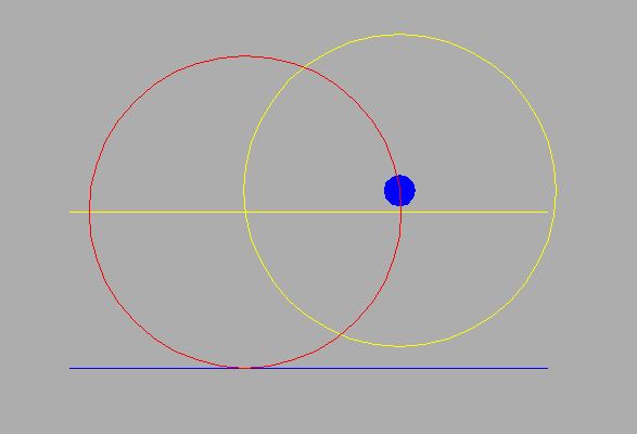

Quite often I need to draw an arc that starts at a specific point, ends tangent to another line, and has a specified radius. What's the best way to do this?

Or if you would like to draw it from first principles:-
In the picture, the blue is the given point and line to be tangent to.
Draw the yellow circle equal to the given radius, and offset the line by the given radius to give the yellow line. The required red circle is centred on the intersection of the line and circle.
Then trim the circle to give the required arc.
