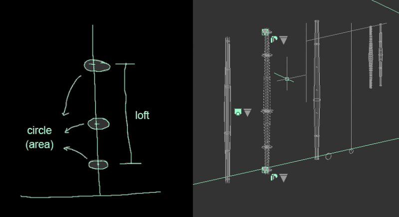

I'm making these legs for a piece of furniture. I need this to be a solid object.
So I drew a vertical line, set the radius using circunferemces. Then (can't remember how, it was long time ago) I manage to turn them into surfaces (circles, so it's an area).
Now when I loft them, it won't result in a solid. Why?!

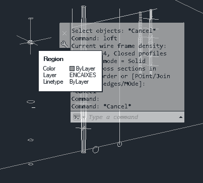

Look at the MO option in the command line, it toggles between solids or surfaces.
I've done that already :s

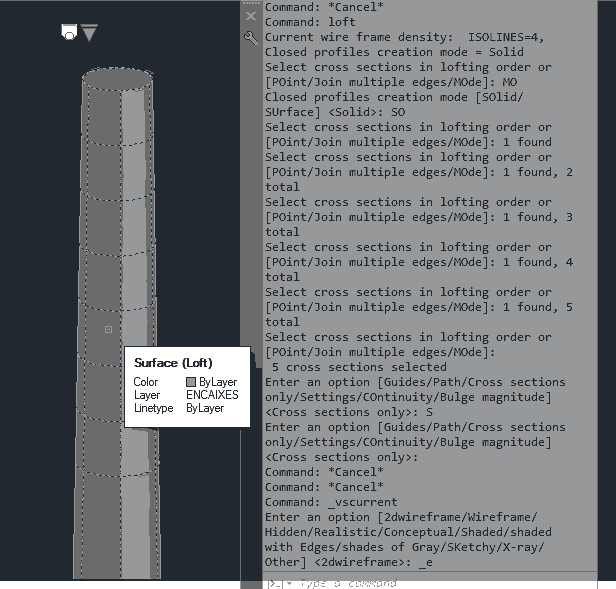

See I'm using surfaces
See command window
