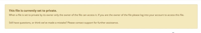

ReMark Posted June 12, 2013 Share Posted June 12, 2013 Tried to download your drawing but this is as far as I could get. Quote Link to comment Share on other sites More sharing options...
imksa Posted June 12, 2013 Author Share Posted June 12, 2013 Are you using an Arial font? Yes, and try with other fonts with the same result, the default font slim and unclear Tried to download your drawing but this is as far as I could get. Sorry Now drawing became public Quote Link to comment Share on other sites More sharing options...
