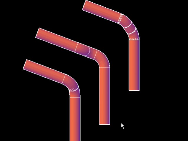

nestly Posted June 11, 2013 Posted June 11, 2013 (edited) How do I model (or calculate) the fewest welds/fittings required to change angle and elevation in a pipe run, as shown in Option1 below. For this example the constants are: 8" standard steel pipe, one of the fittings is a standard butt weld 45 (12" radius), bend angle is 70 degrees, and the elevation change is 9". The custom fitting is cut from a standard 8" long radius 90. Note: Option2 is just shown for reference, I'm only interested in solving Option1 Edited June 11, 2013 by nestly Quote
nestly Posted June 11, 2013 Author Posted June 11, 2013 BTW, the solution does not have to be modeled with 3D objects if anyone wants to use lines and arcs along the centerline, but tangency must be maintained for all segments/planes. Quote

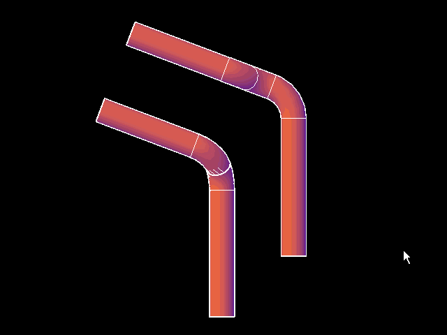

nestly Posted June 11, 2013 Author Posted June 11, 2013 (edited) In process piping, small offsets and cut-back fittings are very common. Option2 is what's commonly used because it's easy. I refuse to put 3 fitting together like that because; 1) it's more welds and/or more cut fittings 2) it looks like garbage. I was "hoping" AutoCAD MEP could do it automatically via routing preferences, but it appears not. Surely there's a math solution, but I've yet to find the person that knows it. Hopefully, this won't detract from the original question, but there is a solution that doesn't require cut-back fittings. The 3rd scenario at the top right (below) uses two standard 45, but I still don't know how to calculate the length of pipe between the 45s so the total angle will be 70 with a rise of 9" Edited June 11, 2013 by nestly Quote
tzframpton Posted June 11, 2013 Posted June 11, 2013 I guess we just see things differently. Like I previously stated, to me, it takes more labor to calculate, custom cut two fittings, then weld them together versus simply welding three fittings. You're taking two cuts and three connections of welds, versus zero cuts and four connection of welds. Plus, it opens more room for error. The last process piping job we did was for Whitewave Foods, which was a $15M mechanical contract. HUGE friggin' job, and we did it 100% BIM. There were about 30 different piping systems - carbon steel pipe, socket weld stainless, aluminum, copper, you name it and it was there (as far as piping goes). Never did we once custom fab any fitting. But, AutoCAD MEP can do this but it takes some effort and manual calculation. In this particular case, you'd have to use precise custom fittings to start with. Still... it's not an automatic process. But things like rolling offsets, oh yeah... AutoCAD MEP can do all day long. Quote

nestly Posted June 11, 2013 Author Posted June 11, 2013 Cutting the fitting is not the problem, that's basic stuff, it's calculating the fitting angle(s) needed to turn a pipe run at and odd angle while changing elevation at the same time. I've been fitting pipe for 24 years and I've never seen a method to solve Option1 in any pipe fitters book. It's been trial and error, be it in the field or sitting at a cad station. I was thinking it's time to learn the easy way. Lets not focus on the logistics, just think of it as a math or cad problem of how to maintain continuity between lines of different angles and different elevations using two arc segments. Quote

steven-g Posted June 13, 2013 Posted June 13, 2013 I'll start of by saying I have no engineering/pipefitting background, so I based the bends on a centre line radius, and cut them off at exactly 45°. But with trial and error came up with Option 3 two 45 bends and a straight section between of 8-1/4". The bends are blocks and have a rotation parameter, surely someone with a program like inventor could come up with a method to link all this using constraints. It may not all line up perfectly, but I bet its close. Pipes.dwg Quote
nestly Posted June 13, 2013 Author Posted June 13, 2013 Putting a rotation parameter on the 45 elbow is clever, and I'll probably use that in the future if I can't find a calculated solution. I think constraints would be just the ticket in a program that could apply them in 3D. Option3 is preferable to Option2, but Option1 is really what I want to solve. Unfortunately, it appears to be the most difficult to solve. Quote
