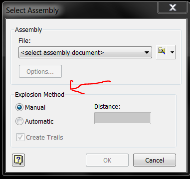

There is no easy way to make an exploded parts diagram in generic AutoCAD. Try Inventor instead.
Move isn't all that difficult in AutoCAD and now with the Gizmo it is very easy.
or
if you have access to Autodesk Inventor - even easier.
Simply start a new Inventor Presentation (*.ipn) and follow the screen prompts.

that Inventor tool looks like it would be ideal.
but 'move' it will have to be
