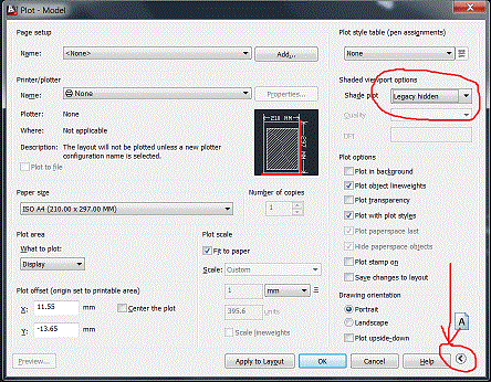

steven-g Posted June 12, 2013 Posted June 12, 2013 (edited) In Block Editor pick your line and give it an elevation. Back in your drawing use the hide command, and for plotting use the hidden line option, not sure what it will be in your version of CAD Edited June 12, 2013 by steven-g slleping mistake Quote
TwistedVision Posted June 12, 2013 Author Posted June 12, 2013 neophoible said: Well, I don't have great news. I tried using a PLINE, A Solid Hatch, a WIPEOUT, the built-in Masking of MTEXT, and a SOLID, all with the same results--the Attributes came out on top every time. The only two options I can think of are: 1) Use the exact same color for the line and the text; 2) Nest the attributed block inside a block with the obscuring line. I would opt for the simplicity of the former. The latter might require a lot of pain and suffering overall, though I have seen it done (but not for the purpose you are seeking). Thanks for the effort! But that's probably not gonna do it. steven-g said: In Block Editor pick your line and give it an elevation. Back in your drawing use the hide command, and for plotting use the hidden line option, not sure what it will be in your version of CAD I'm not sure what you're saying, I gave the crossing polyline an elevation in the block, but when I use the HIDE command in the drawing, the hatches and fills simply disappear and I can't zoom in or out untill I REGEN the drawing. And where can I find the hidden line option for plotting? I tried HLSETTINGS, but I'm not sure what to do with it. Quote
steven-g Posted June 12, 2013 Posted June 12, 2013 Sorry, yes it does freeze up your drawing untill you do a regen, but you did say it was for plotting, the command SHADE may also work better (as I said don't know if it will work on your version I have LT). For plotting, the setting is at the right hand side of the plot options dialogue. Quote
neophoible Posted June 12, 2013 Posted June 12, 2013 TwistedVision said: Thanks for the effort! But that's probably not gonna do it.You're welcome. Sorry it's not a possibility, as it seems to be by far the simplest solution. I hope you can find smth suitable. I can think of other options that would be far more complicated, but they would entail some sort of LISP routine. If you can't find anything here, you might try fishing for solutions in that subforum. Quote
