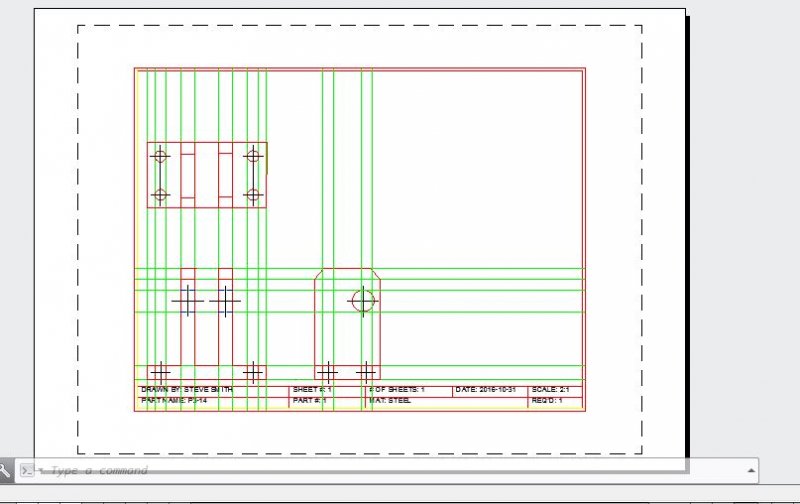

Hello, I am looking for some help on some projects I am doing for Penn Foster. They are Orthographic projections. I am trying to get the inside border of my layout to be 3/8th of an inch from the edge of the paper. For some reason the border looks to be about 3 inches from the edge. I'm basically trying to enlarge the viewport by making the border bigger or getting rid of it entirely. Also, do I scale the inside block of the three views, so I can see them closer? Thanks any help will do. The professors at pf would probably take a couple of weeks to answer, and I'm sure I would have to repeat the question and/or rephrase it. Here's a snapshot.
It sounds like all you are trying to do is to GRIP stretch the corners of your viewport to fit a known rectangular dimension. You could create a closed polygon over the line representing the edge of your paper, then using the OFFSET command offset it can stretch your viewports corners to those points. Alternatively you could use the create viewport OBJECT functionality, and turn the offset line into a new viewport, right where you want it.
The size of your viewport does not necessarily have to match the size of your border. For that matter you don't necessarily even have to have a single viewport. You could have four separate viewports if you wanted to.
You knew the size of the paper you were going to be printing to. My question is, why didn't you draw your border to fit accordingly? It's like you drew your titleblock and border without regards to size at all. Is that the case here?

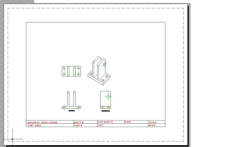

Looks like that worked Dadgad. thank you
ReMark: 1: they are 2D. 2: No dimensioning for the first two projects. 3: Yes I am familiar with the annotative scaling. PF gave me the dimensions they require for the text. I have since started over, and have made the projection I was looking for. There was an issue with the blocks, so I restarted a whole new project. Thanks. I'm sure I will have more questions to come. thanks guys.

Is your border in model space or in paper space
Can you attach the file here?
My guess is that the border is in modelspace and the entire paper space view is scaled.
The picture should show that it is in paper space. I started the project over and then i inserted the title block. Everything looks fine now. I've had a lot of trouble with this autocad. I had to reinstall it twice. The program is a 2010 student only edition, so PF must of saved a ton of money.

The picture should show that it is in paper space...
The picture shows paper space, it is not possible from a picture to determine whether border or geometry is in paper space or model space.
Attach the file here. If you had attached your file to the original post you would have gotten complete and accurate information in the very first response.

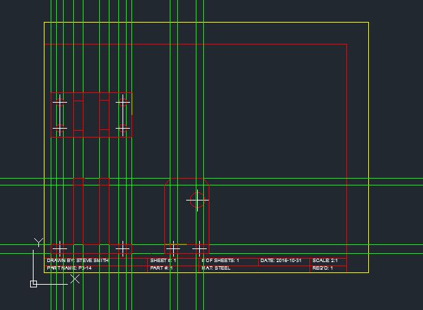

I think i got it? Any input would be appreciated.qfn7q95aNPhz91t4Mnfph8rsk8PL3AE00EcBb+H7HgYMQ7Ux2BAAAAAElFTkSuQmCCAA==
Edited by sjsmith
only thing i am really wondering is do i need to add the hidden lines for the big circles on the bottom left view?

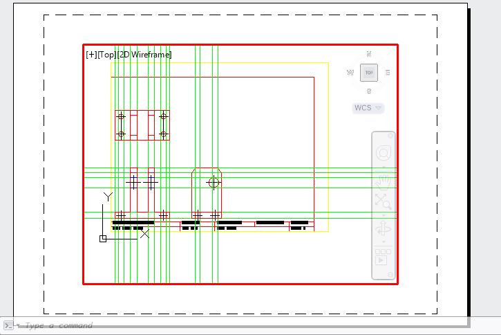

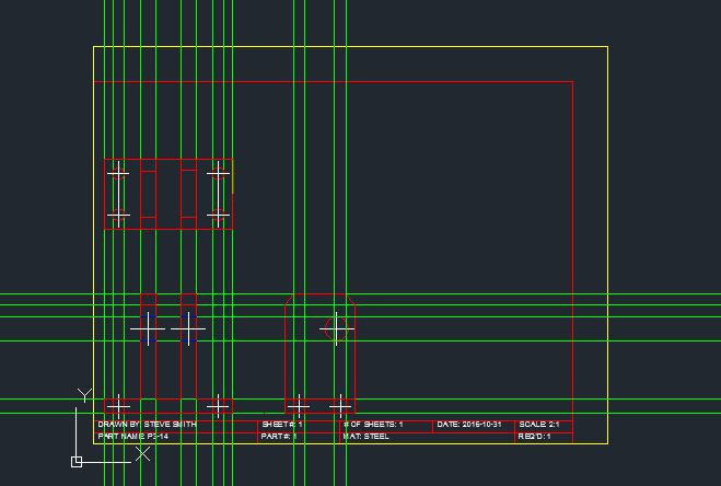

I added the hidden lines. these are the my model space, and layouts 1 & 2. any input would be great.
Please attach a copy of the drawing to your next post so we can have a closer look. Thank you.
