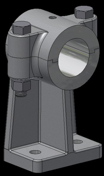

A question for Iggy Stardust: The height of the "ears" on either side. Is that 1 3/4"?
Looks like 1.75 from split line on both sides, but I don't think it is dimensioned.

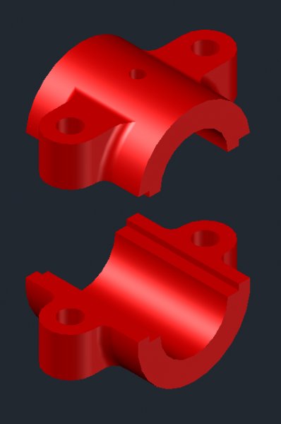

1.5 hrs work for 3D, detailed 2D drawings would be another 30 min or less.
Yes, I agree with the 1 3/4" dimension after trying it using 3/4".
Might be nice to know if the OP is doing this as a 3D model or a 2D isometric.
Try UCS view
Specify origin of UCS or [Face/NAmed/OBject/Previous/View/World/X/Y/Z/ZAxis]
: v
[ATTACH=CONFIG]42320[/ATTACH]
I decided on the 1 3/4 for both sides after seeing the length of the fastener (which is specified).
