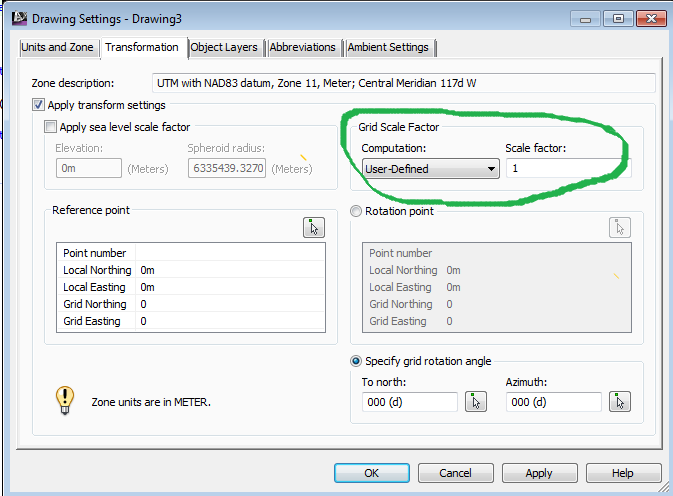

but gridunit sys variable specifies grid spacing for the current viewport. I am trying to get a user-defined Grid scale that is set from drawing settings window in transformation tab.

I couldn't find transformation tab in the Drawing Settings Window in my Autocad 2014
on the command line I type in "editdrawingsettings" and then click on transormation tab and set the user-defined grid scale factor value
That option might be available only in Civil cad as it is shown into your profile , can you upload a snapshot of that dialog ?

This is only available in civil3D
Unfortunately I do not either have or work with Civil3D but we have lots of nice guys in this forum using that Cad version and they are very helpful guys , so just wait and you should have your question answered in no time . :)
